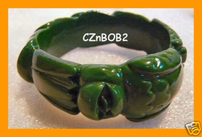

Thanks all for your input. I am really reluctant to put heat to this
piece, it is shaped like parrots and palm trees with a lot of
detail, and if it is softened, wont these details be in danger? Also,
it is a bangle, not a cuff, so adjusting the curve is not an option.
There is a bracelet just like it on ebay, with good pictures, if you
want to see what I am talking about.
http://www.ganoksin.com/ftp/disney-lucite-bracelet.jpg
Thanks, Marggi
Hi Marggi,
After looking at the tiki bracelet, I think Neil’s suggestion of
cutting the bracelet into two or three pieces and using end caps to
connect them is the only thing you can do. The caps will be complex,
since the thickness is not uniform. They should also be pinned or
riveted and glued like Neil suggests. I don’t think you can grind out
enough material to make it large enough without weakening it. Here’s
a photo of a jade bracelet that is done in sections like that. I
would use heavier, double jump rings to connect them instead of how
they did it, however.
Lauren
