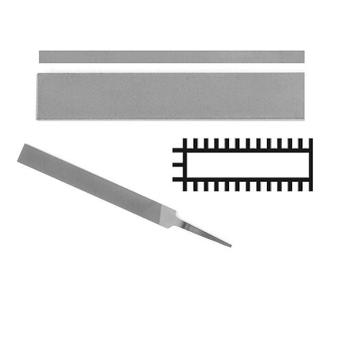

Paige clearly defines where their tips should and shouldn’t be used. M for soldering, MX for melting and MA for annealing. I learned this the hard way when I was using a #2 M to fuse the edge of copper bracelets back when I still ran regulated propane and O2… The tip came apart as it was exposed to heat outside its design range. I discussed this with Richard and bought another #2. I have not had a problem working with Piage Tools and am sorry that others are. This is something that Paige Tools should address. On another subject, I very much need to buy a Swiss #2 flat file. Rio is out of them and all other files from the same supplier. I have gotten two different answers to my question of when they might be in stock, both at least a month out. I don’t want a German file because I have never used them and they are numbered differently. I have had trouble finding out what the German equivalent is to a #2 Swiss. My thought is that a company that makes money supplying people who do what we do should always have in stock something as basic as a #2 Swiss file. We have been bashing suppliers lately. I think that it is fair to pass on our experiences with suppliers both good and bad…Rob

Here’s a conversion chart for files:
File numbering system, german to swiss cut conversion table
Friedrich Dick are great.
– alonzo
Otto Frei has 4", 8" and 10" flat files in a Swiss #2 cut, if I read this right:
