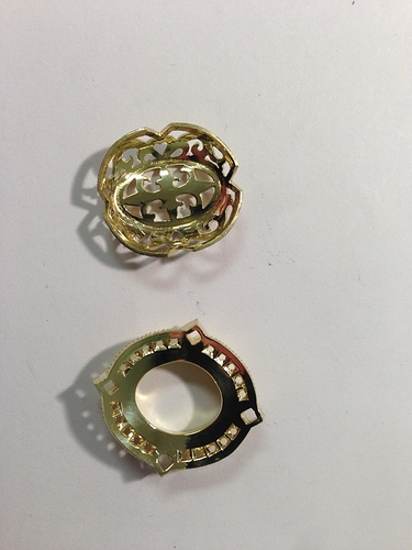

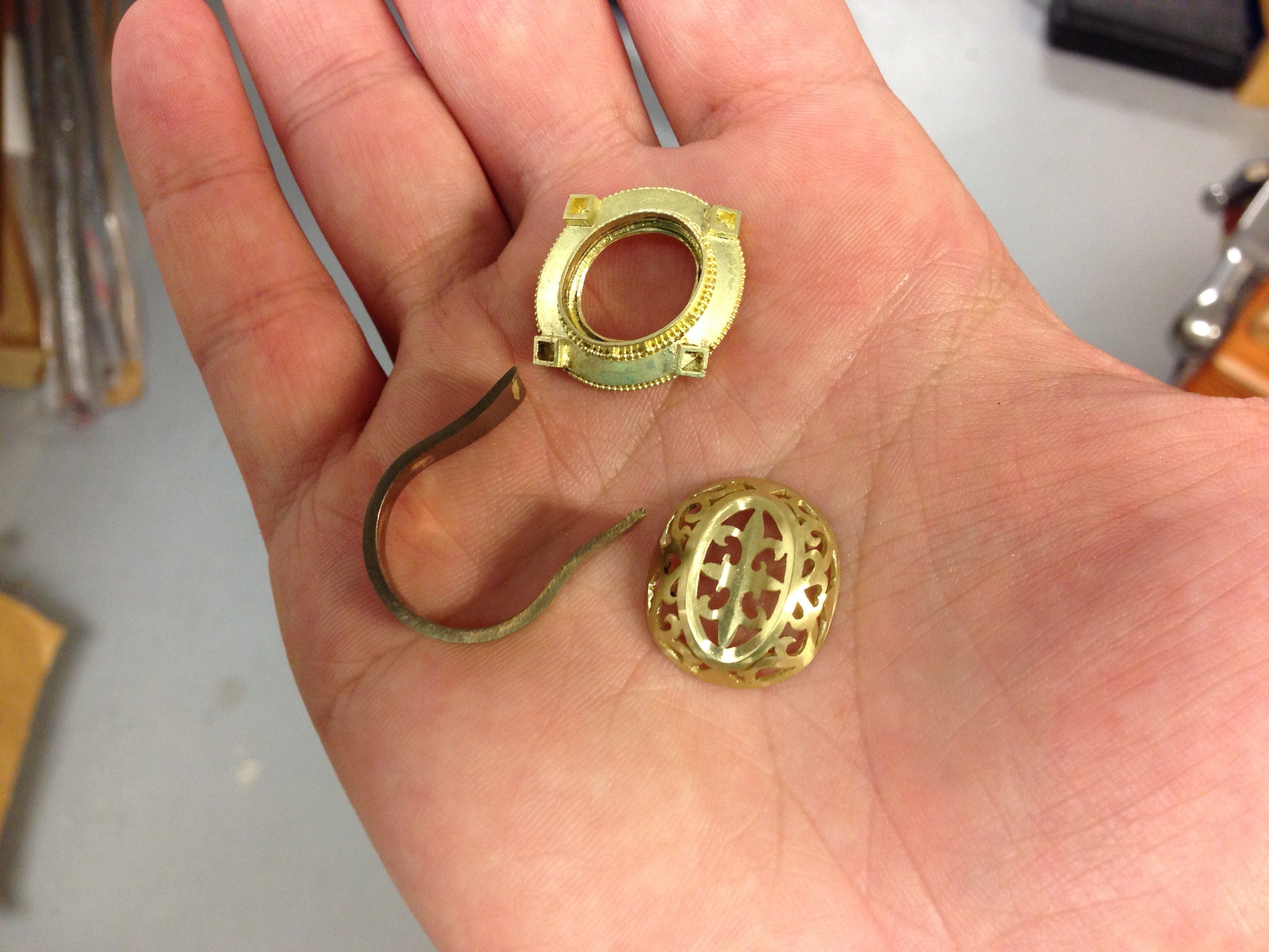

Thanks for your reply, it was the 18K granulated ring with Black Star Sapphire, Rubies, and Diamonds (Classical Collection). The piercing work is amazing. Im interested in the steps taken to fabricate.

Thank you Michael. I’ll see if I can get some pictures posted of the process in a bit. I’m pretty sure I took some as I made it for my FB page, but I don’t think I put all of them up there. Stay tuned!

So a step that I missed in photographing was that once I made the bottom portion of the ring (the gallery area, not the shank), I then covered it with China white and drew on the pattern for the pierced area with a pencil. From there, I was able to drill some holes, thread the sawblade through and pierce out the design.
