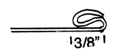

Bend 4 strands into an “S” curve using forming or flat pliers.
Close loop ends. The “S” should be approximately 318 inch in length.

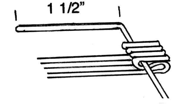

- Making the first knot:
a. Bend 1 112 inches of the ten inch piece at a right angle
b. Feed the long piece of the wire through the “S” (either loop
of the “S” will do)
c. Wrap around the “S” curve AND wires underneath. Wrap the
entire length of the “S” and put the end of the wire through
the other loop of the “S”. One end of the wire should be
pointing toward you and the other end away from you.
