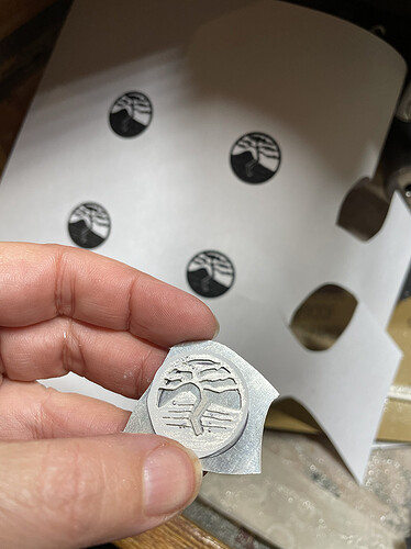

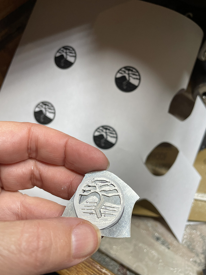

Hi all. I’m trying to transfer an image of a small acacia tree to 925 silver.
925 silver - sanded and cleaned, ready for application.
Image - printed on a laser printer, black ink.
I’m using 100% pure acetone over the image (with a q-tip) onto the silver, and I’m not getting a strong enough impression to saw.
Does anyone have any tips? Or other techniques to get a strong image transfer?
Thank you, T

The image is there to provide an outline so I can saw out a shape. Thanks for the tips, I will try your suggestion.
Start with carbon paper and gesso. Your only challenge be lining the image up since you can’t see through the carbon paper. One way around this is to glue the carbon paper to the back of your image paper and then cut both out in the exact shape of the piece that you want to transfer the image to. Tape the metal down, then tape the image paper and carbon paper down so that it follows the shape of your metal. Obviously you put on a water thinned coat of gesso first and let it dry. It helps if the metal is clean. This allows the gesso to fully cover in one coat. You don’t want it too thick. I do my tracing with a very thin metal stylus. Make sure it is polished so that you don’t push the paper around or punch a hole in it. The TW Design kit works well, but you need an inkjet printer and you use up a lot of black ink and paper getting it right. Another trick is to draw your image on a large adhesive label and then tape it to the metal. You can saw through it without any trouble. Good luck…Rob
Rob, that worked like a charm. Went out to purchase some carbon paper and gesso, the gesso is key.
Cannot thank you enough. :slight_smile:
