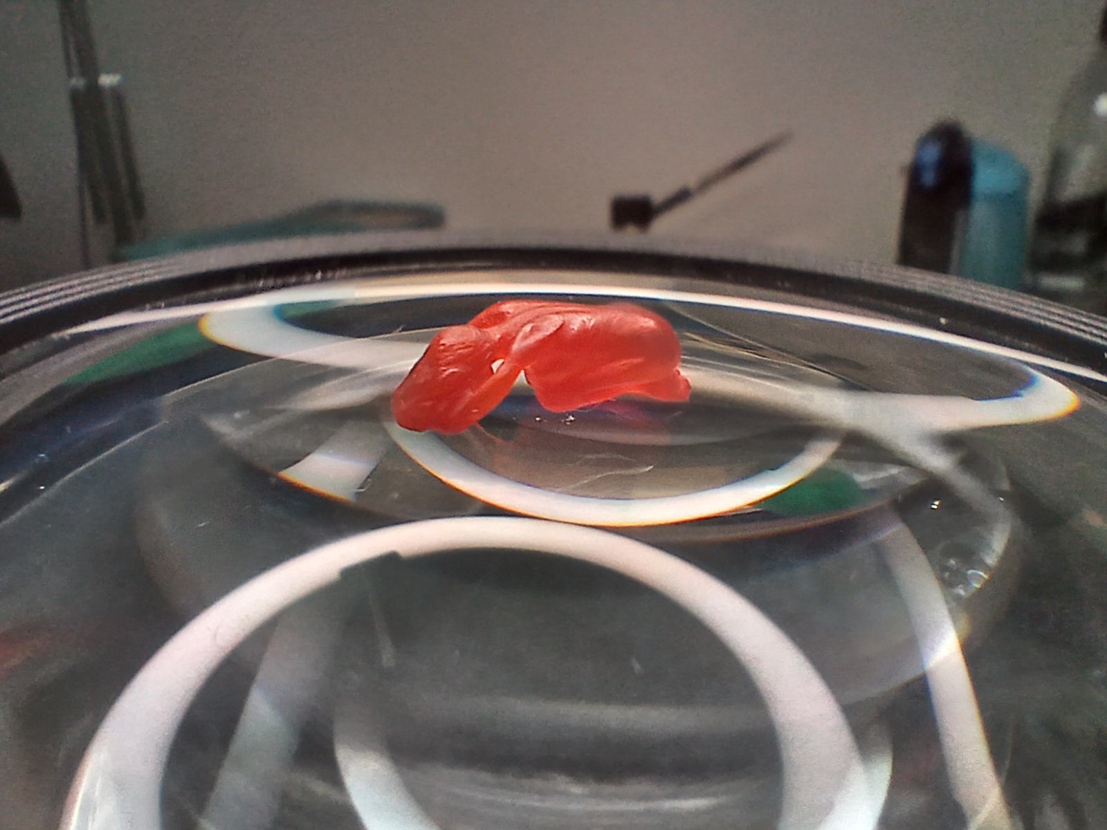

So I carved this little carnelian lady and now I have no idea how to set her. Someone suggested open pendant setting but I have been looking at them and not sure how to that would work. Any suggestions?
This is a video of all sides:
https://www.instagram.com/p/DFrKTGoucm-/

Oops, much smaller than I envisioned.
Nice though.
How are the hardness and brittleness of the material?
If you doubt it, maybe you need to bild a kind of crib that protects her without hiding her?
It’s carnelian so I think she’s good. She will have to be a pendant though, I wouldn’t trust her in a ring.

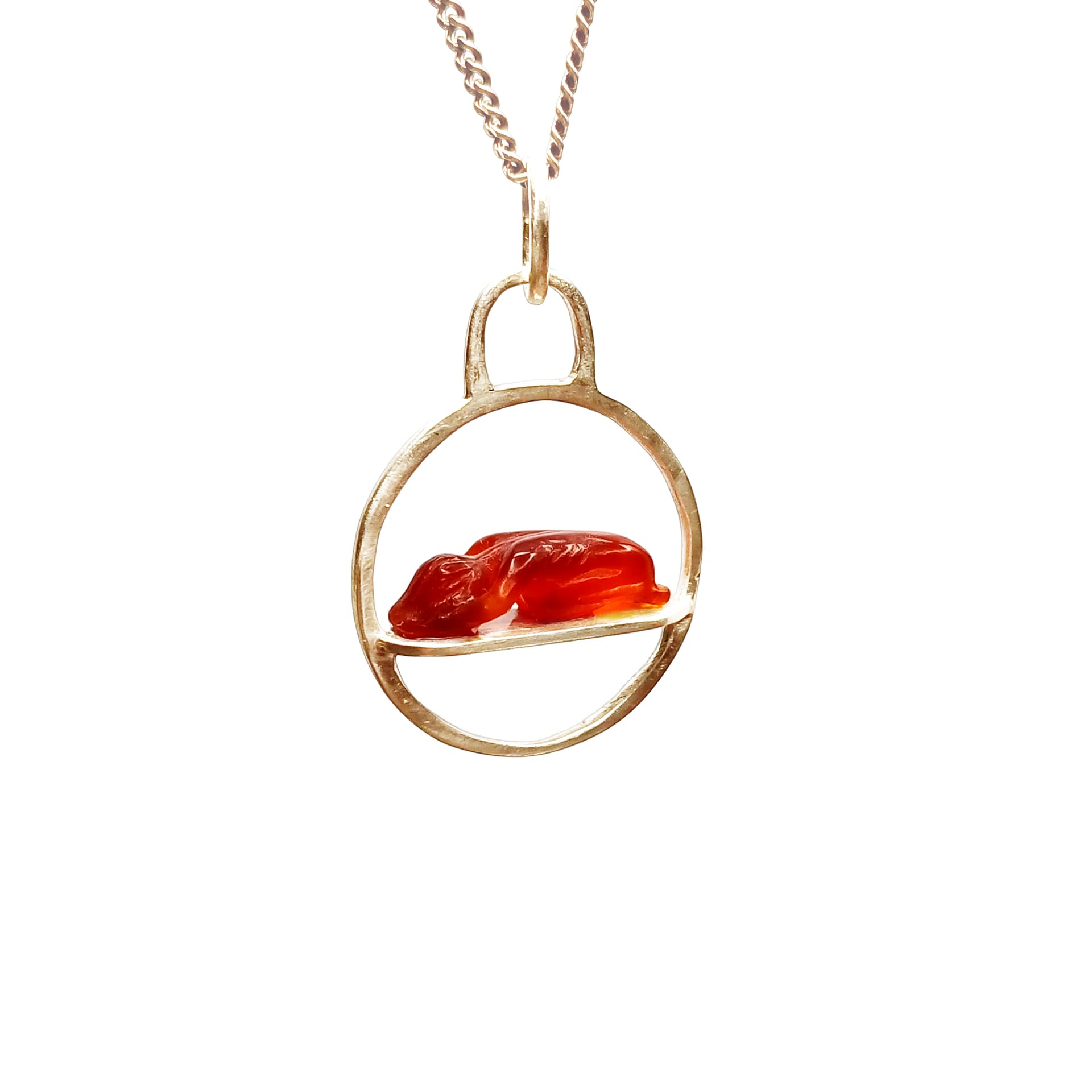

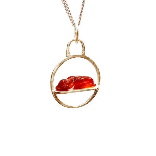

Thank you. I ended up going with this:
Nice! How is it secured in place?..Rob
Hi,
Looks perfect! the floor makes total sense! I am feeling the “repose”~!
Julie
Thanks. There are two posts on the base, one goes into her head and the other, her knees. I carved them like little screws and added a little dab of Epoxy 330.
