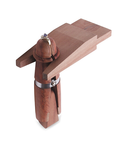

One from Pepe:
Another is a variation to the old school ring clamp/bench pin combo.

I have those. The mohogany one drives me insane. It constantly falls from the bench block constantly. I wish i could buy the benchmate system so much
