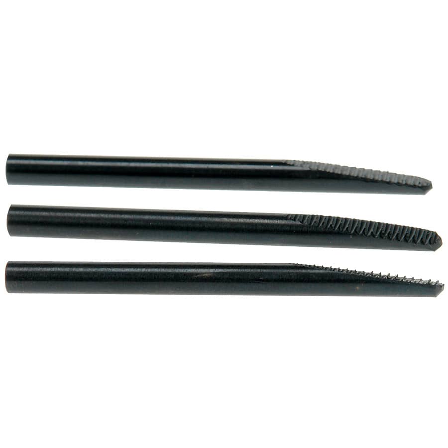

for the “jaw points”, there are little black “set screws” on the heads…screw the set screws out a bit, using the appropriate sized tiny hex key, to release the jaw points…insert new jaw points, and screw the hex screws back in, hand tight…be sure to orient the jaws correctly, so that the serrated sides are opposing each orther.

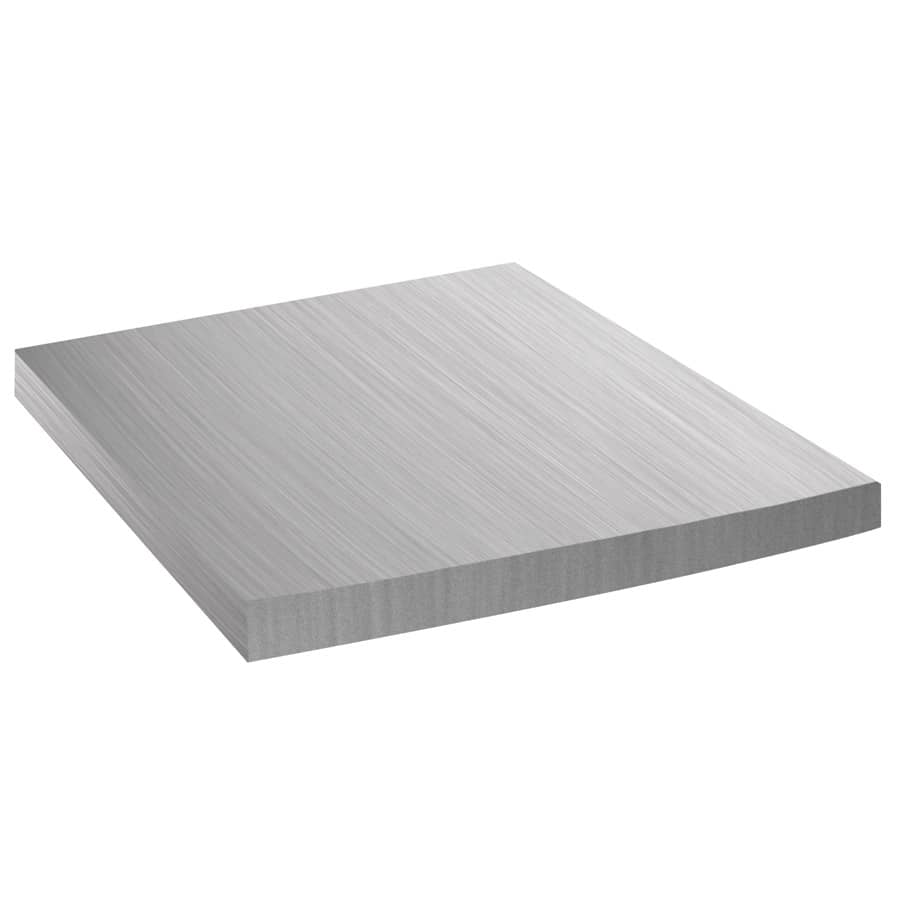

Ok … is there any reason not to flip the solder board over and use that instead of a new one? Budget stuff.

Hi,
oh, for sure you can turn it over and use the other side…

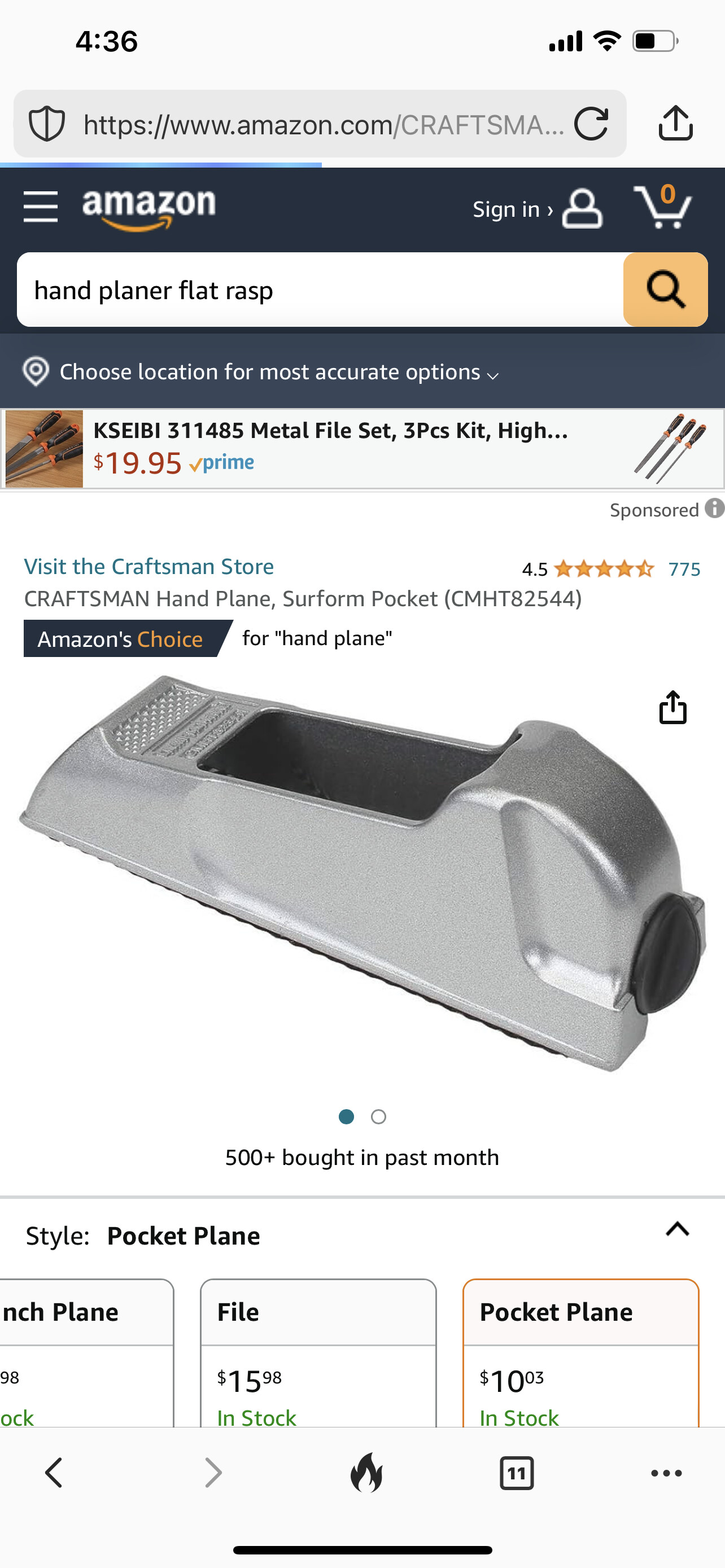

mine has not gotten all flux coated…yet…but for my solderite boards i taken and rub them on cement…or use a pocket plane hand plane rasp and rub it over the bumpy flux to remove it
https://www.amazon.com/CRAFTSMAN-Plane-Surform-Pocket-CMHT82544/dp/B07QCR112J/ref=mp_s_a_1_13?crid=13E2LCG051KUD&keywords=hand+planer+flat+rasp&qid=1694734485&sprefix=hand+planer+flat+radp%2Caps%2C174&sr=8-13

Ty!!! I need and love a flat board without fluXyness. Thank you!!!

right now i am still using the same 6”x6” non-asbestos board it came with…(max temp 600F…interesting…)…
i am usually soldering items being held up in the air when i am using this contraption…versus on the heat reflective board
i have 6”x6” solderite boards that i can change it out with…
julie
Hi,
me too! so! i have a few different boards
one is nice, flat and clean and not fluxey, that i use when i need a flat flat surface…
one is totally a flux covered disaster, that i use when i am gonna spray on Prips barrier flux…especially for repeated annealing
one is a disaster that has been scraped sort of clean and flat that i use for the rest of the soldering jobs
and i have a few new boards waiting in the wings for emergencies
julie
