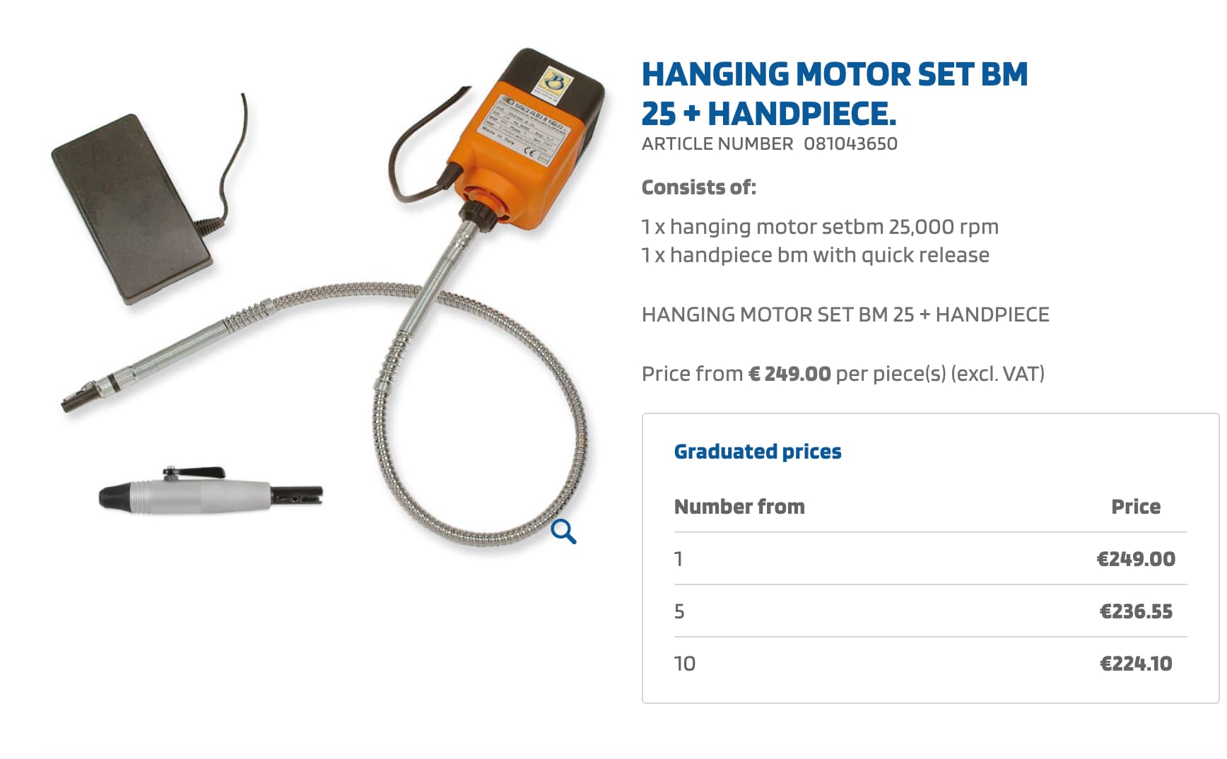

Hi all,
I need to buy a flex shaft… i can’t afford a foredom right now, can anyone tell me if this seems like a decent compromise? I need to drill holes, polishing, grinding etc.
Thanks!

I would have a few questions:
1( does the listing specify what size burs fit in the quick cgange collet?…ie: it is usually 3/32” …ie is it standard or metric?…
  1. also, will the flex shaft (key, at the end) fit other handpieces?…ie: a jacobs #30 chuck handpiece?…this handpiece collet opens and closes to accept various sized burs…and wires (for twisting etc)…and is good to have…or…a hammer handpiece?…
Peter Keep did a video reviewing different hammer handpieces, and i noticed he had 2 different flex shafts with different flexshaft “keys”…(he is in australia)

Hi,
here is a video by Andrew Berry’s “AtTheBench” YouTube channel, where he reviews the various Flexshaft shaft styles and handpieces that fit in them
(5 minute mark- Euro Slip Joint, and USA key joint)
he also reviews “QC” Quick Change handpieces and keyed chuck handpieces) ie: the #30 Jacobs chuck handpiece)
the #30 Jacobs chuck handpiece collet opens wide and closes down completely…ie: for use with burs and drills that do not have a 3/32" shaft…ie: a tiny twist drill…

A quality tool will pay for itself, while a compromise will only make you appreciate, later, why you should have gone with the quality choice to begin with…
I have been buying tools for over 50 years. What we recommend depends a bit on what you want to do with a flex shaft. A flex shaft is one of the few tools that I would go into debt to replace. I have two. I purchased the first one probably 45 years ago and it is still going strong. It has two speed ranges resulting from the fact that it has two output gears. Low speed with torque is needed for some tasks and high speed for others. I use it mainly as a bench mounted lathe, but also to drive my hammer tools. Hammers need to be run at low speeds. The other, newer model, is my go to for any one of a number of higher speed, yet powerful, tasks. Several quality suppliers that we use also sell Grobet tools. You might take a look at them as they offer several lower cost flex shaft packages. You might consider starting with a Jacobs type handpiece as it will accomodate a range of tools sizes. The quick change handpieces are specific to 3/32 " tools. You will find that the flex shaft is just the beginning. The cost of the tools driven by them may cost far more than the cost of the flexshaft depending on what you want to do with it. The cost of tools is a real challenge. It never goes away and just gets worse as you get more experience and buy more expensive tools. Don’t just buy tools. Let the need for them appear first. You then can make a much better informed purchase. So many people starting out thinking that it is the tool that will make them a better jewelry maker and the lack of it is standing in their way. This is not entirely true. I have a small museum of tools that I had to have that I have never used. There is a lot of great jewelry made with very crude tools. Take a look at the Toolbox Initiative run by Tim McCreight and Matthieu Cheminée.
Keep us posted on your progress and don’t be shy about asking for suggestions. Remember, tool catalogs are made to sell tools, many of which you likely don’t need or don’t need right away. Sometimes the solution to a problem is fairly simple and not that expensive. Many times you can make the tool yourself. Good luck…Rob

Hi again,
ah, I see…the OP’s listing shows a Euro Slip style flexshaft and handpiece…
i would suggest, looking around, to see which handpiece styles are available in your country as well, for future additions
