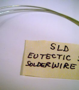

Beth Katz at www.myuniquesolutions.com sells IT and eutectic silver solders. I believe they are either paste or powdered. The IT has a high flow point of 1475F that is probably higher than most vitreous enamels. People us it to solder on findings. The eutectic solder is also fairly high temperature solder and it’s around 1435F according to the facts at Beth’s website. Eutectic flow is the lowest temperature where the silver and copper melt together. This solder supposedly can be enameled over without causing bubbling or spalling enamel.

eutetic silver/copper is 72 percent silver, 28% copper… this alloy has a grayish color. Not the color of sterling… adding zinc will lower the melting point further, brighten up the color, however you will have to look up a three component phase diagram… the liquidus points vary with composition and form curved lines within a three component triangle.
I learned the hard way that enameling over solder joints containing zinc results in disaster. Transparent enamels that normally have beautifully vibrant colors will chemically react with the zinc and cause the colors to look dull and “muddy”. Both transparent and opaque enamels react with zinc and cause the formation of bubbles in the enamel, and over time the enamel will become brittle and flake off the metal until all the enamel is gone and only the bare metal surface remains.
I did research on the topic of soldering fine silver components together prior to enameling, which in turn led me to detailed information on various types of solder. As it turns out, the archives on this site contain a treasure trove of information on both topics. You may wish to search for terms like “Eutectic solder” and “solder for enamel”.
I learned that most silver solder formulas contain fine silver with varying amounts of copper added to lower the melting temperature. The more copper content, the lower the melting temperature. Zinc is added to improve flow characteristics. The most common solder formulations are the familiar Extra Easy, Easy, Medium, Hard, and Extra Hard variants.
IT is an acronym that stands for Intense Temperature. As the name implies, IT Solder has a much higher melting point than common solders. However, most IT solders also contain zinc to make them flow more easily. This is not an issue in some applications, such as when soldering a bail onto the back of a brooch when the back will not be enameled (or counter-enameled). But if IT solder is used to join parts that will later have enamel applied over the solder joints, the zinc will definitely pose a problem.
The term Eutectic refers not to silver solder, but instead to a system or mixture that has a melting point lower than the constituent parts:
When used in reference to silver solder, Eutectic refers to a formulation of fine silver and pure copper alloyed in proportions that produce a melting point of ~1460°F (793°C). This is both comfortably below the melting point of fine silver at 1763.2°F (961.8°C), and safely above the fusing temperature of vitreous enamels at 1450°F (787°C). Parts joined with Eutectic solder will not fall apart in the kiln while fusing enamel to the metal.
Eutectic solder has very different performance characteristics as compared to common silver solders containing zinc. The zinc-bearing solders go from solid to an intermediate “mushy” state before starting to flow as the temperature reaches the liquidus point of the alloy. By contrast, Eutectic solder does not have this intermediate “mushy” state. Instead, it suddenly goes directly from solid to liquid when the precise liquidus temperature is reached.
The lack of zinc makes Eutectic solder more difficult to work with because it does not flow as easily, but one can use a solder pick to “convince” this “stubborn” solder to flow where one wants it to go. This takes a little experimentation and practice to learn, but works very well with just a little experience.
