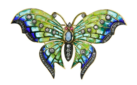

But my personal preference in jewelry design is Art Nouveau style pieces inspired by the designs of René Lalique, Georges Fouquet, Henri Vever, Philippe Wolfers, and Lucian Gaillard. If I wanted to begin producing heirloom quality Art Nouveau style jewelry, I would have to learn to produce Plique-à-jour style enamel.
Unfortunately, all attempts to produce Plique-à-jour with a torch ended in disaster. This style incorporates enamel that is wet packed into the openings in a pierced metal base, so there’s no enclosed cloison/cell to keep the enamel from slumping out of the opening when fired. I tried many different jury-rigged contrivances to keep the enamel in place, but it was all in vain.
