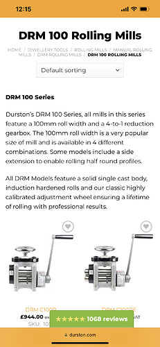

I am also curious what people think about the Olivia mill. I have a Durston DRM100 that has gotten very little use over the years. Every time I attempt to roll out some sheet with just paper textures, I pull my shoulder out (I have Ehlers Danlos Syndrome). This last time, it was 2 months of pain before the ligament heals and moves back into place. I don’t know if 4:1 or 5:1 gear reduction will be much better. I’ve watched several videos of the Olivia, and it looks like there is a lot of spinning of the wheel. Inertia does some of the work, but it does take more time. I really wish there was a way to try before you buy. I’m going to get in touch with some of my jeweler friends that live near me to see what a “normal” gear ratio feels like, but the Olivia is as far as I feel I can go as far as expense. It still feels like it’s out of my budget, but I have so many things I want to do with patterned metal - one specific pattern. Any more input would be greatly appreciated!

According to the Durston website, your Durston DRM 100 has a 4:1 hear ratio, which I believe is a pretty standard, or “normal” gear ratio.

I was mistaken on the name of my mill. It is the Durston 100 Mini Mill. It doesn’t have a gear box.

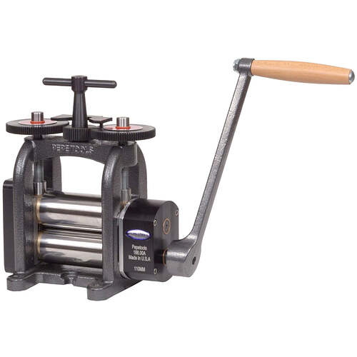

Some of the Pepe Ultra mills are pretty good for the price. This one has a 4-1 reduction gear.

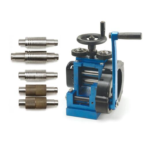

Hi Royjohn.
(a consideration…i believe the economy rollers are more limited in the amount the rollers open up…and the thickness they can accomodate…i just wanted to mention in case your needs require bigger opening)
i believe the maximum thickness for the otto frei blue economy mill is 2mm
julie
The only drawback that I had with the economy mill is that it didn’t open up enough to roll my ingots fresh from the mold. I had to forge the ingots thin enough so that I had enough gear engagement between the rollers to avoid damaging the gears under the pressure of rolling an ingot. I used the failure of a key way in one of my rollers to justify buying the Durston. I still use the economy mill a lot to roll textures. I also run thin strips of metal through the gears to get interesting shapes that I use in filigree…Rob
Thanks, Rob…looking again today at Amazon’s offerings, I find some which open to 5mm and others which open to 7mm…I think the Durston Agile does 6.5mm. I’ll have to look at these mills again and make notes. There are some mills listed on multiple pages on Amazon with different specs and I’m not sure whether these are slightly different mills or if they are misquoting the specs. I guess I’d have to contact the sellers and nail down the specs first. I’d probably order from Amazon so that I could send it back if it wasn’t as specified. -royjohn
Remember that how wide they open does not necessarily mean that the drive gears are engaged enough to safely keep from getting damaged. My Durston has a safe maximum of 8mm and that works for my ingot molds. Good luck and let us know what you come up with…Rob
“I see,” said the blind man…LOL…You make a good point, Rob. Not trying to be argumentative, but aren’t you supposed to forge an ingot some before rolling it out anyway? I think the adjustable ingot mold I have is 4.5mm thick…-royjohn
Yes, I always forge an ingot before I roll it, as that is what the metallurgists tell us to do and it seems to make a difference, but not enough to get it to fit in between the rolls of my economy mill. There was a time when I researched powered hammers to get ingots small enough to fit my economy mill. I don’t need a power hammer now, but I would still like one…Rob

I have an old Cavallin combo mill that I got a deal on and bought used in the 80’s, a Pepe flat 130 mm (that I also got a deal on) to roll out wider sheet than I could with the Cavallin mill and the Blue economy rolling mill. We also have a Durston D4 mill at my job.
I bought the Blue economy rolling mill to texture metal because it has so many easily replaceable texture rollers. I use a lot of textured sheet in my work and it’s great for that. I will say that I bought my economy mill before Trump era steel import tariffs and our current inflation phase. It used to be less expensive.
I love the economy mill for what I use it for, but I wouldn’t be happy with it if I was trying to use it as my one and only, go-to rolling mill. Compared to the other mills it’s kinda funky. It does have a reduction gear, which is awesome, but it’s just not as well built as the other mills. Plus the narrow maximum opening is very frustrating. At least for me.

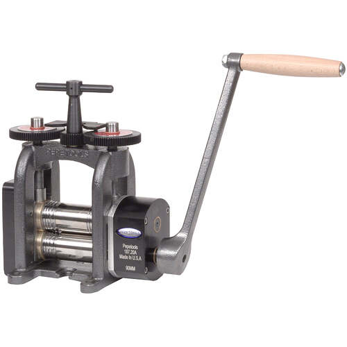

Unless you want a mill with the advantage of easily replaceable rollers, for a bit more money, right now I think the Pepe mills are a better choice.
Here’s a couple of their least expensive models:
