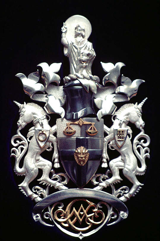

If you need to blacken sections of high carat gold and retain the
metal appearance, then the best way is to first silver plate the gold
section you require blackened, then use standard silver blackening
chemicals to colour the silver plating. I have used this method many
times with success. Of course you can enamel or paint the surface,
but you loose the metal surface by doing this. I use Ammonium
Hydrosulphide diluted with warm water, which gives me a dark silver
grey colour.I also use a liquid available here in the UK called
Liberon Antiquing Fluid, which will blacken silver and copper. Just
make sure that the item you wish to colour is clean and completely
grease free. When I made my end of apprenticeship masterpiece I used
Ammonium Hydrosulphide to blacken sections of the crest, it looked
good and it has retained it’s colour for forty years so far. See it
here http://www.ganoksin.com/ftp/NAGbadge.jpg
Peace and good health to all
James Miller FIPG.
