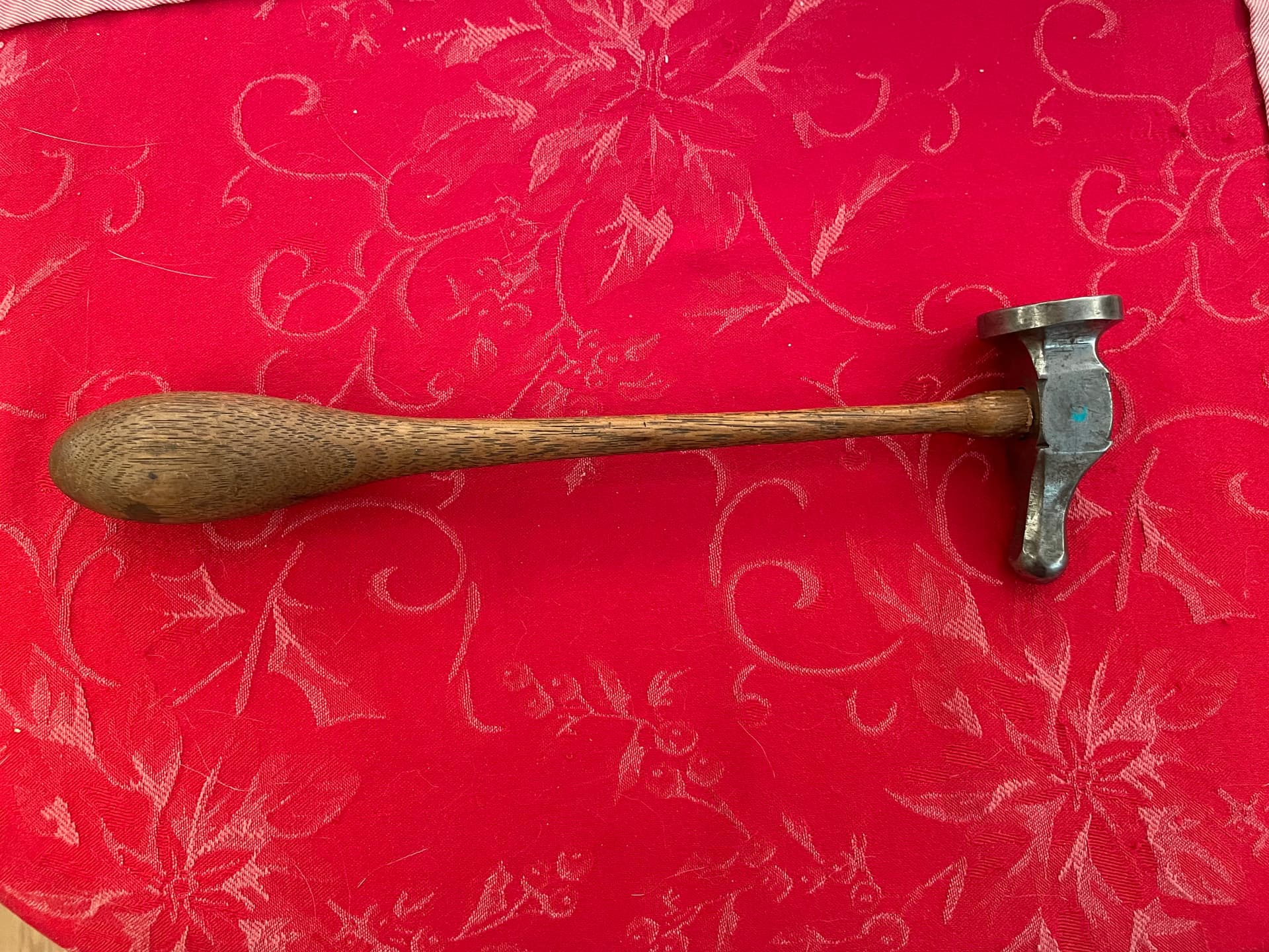

If you can, search online for a vintage Dixon chasing hammer. Mine is stamped Dixon/ France. The one I have is perfectly balanced because of the shape of the handle. So balanced that gently held at the rounded base, it does the work for you and it just lets gravity do it’s job. Thus making it easier on your hand and wrist. The hammer head itself is tough as nails. I’m guessing that mine is at least 50 years old.
I have that hammer and love it. The slight spring allowed by the thin handle helps prevent double strikes.

I have that exact hammer Jo!! And, yes it’s 50 years old. Does Dixon even still make hammers? I was gonna take a picture of it to add to your post, but I can’t seem to find it right now. Embarrassingly, it was the only hammer I had for at least 10 years. I used for everything. Needless to say, the dings on the face presented a problem when using it on metal. I have a hammer fetish. I own a lot of them. It’s just a thing for me. Peddinghaus makes wonderful hammers, I have a few bigger ones. I have a few Peddinghaus forming hammers, but Fretz hammers are my go to. Yeah, I know expensive. I have several chasing hammers in different weights cos sometimes you want a light touch, and sometimes you just want to whack it :slight_smile: I have this tiny thing and don’t remember who makes it. I just looked, it’s GRS. Has a flat face. A big one on one end, and tiny one on the other. I really like Fretz’s planishing hammers and have this tiny one I just love. I think they call it a “goldsmiths hammer” it has a planishing face on one end and a forging cross pein on the other. I can totally see how a planishing hammer could be useful for raising as long as you kept it pristine and polished. I kinda like Rob’s approach. Use what you can find and understand how to use it. It so totally amazes me how ancients made beautiful stuff with virtually nothing. Its not the tools, its the maker.

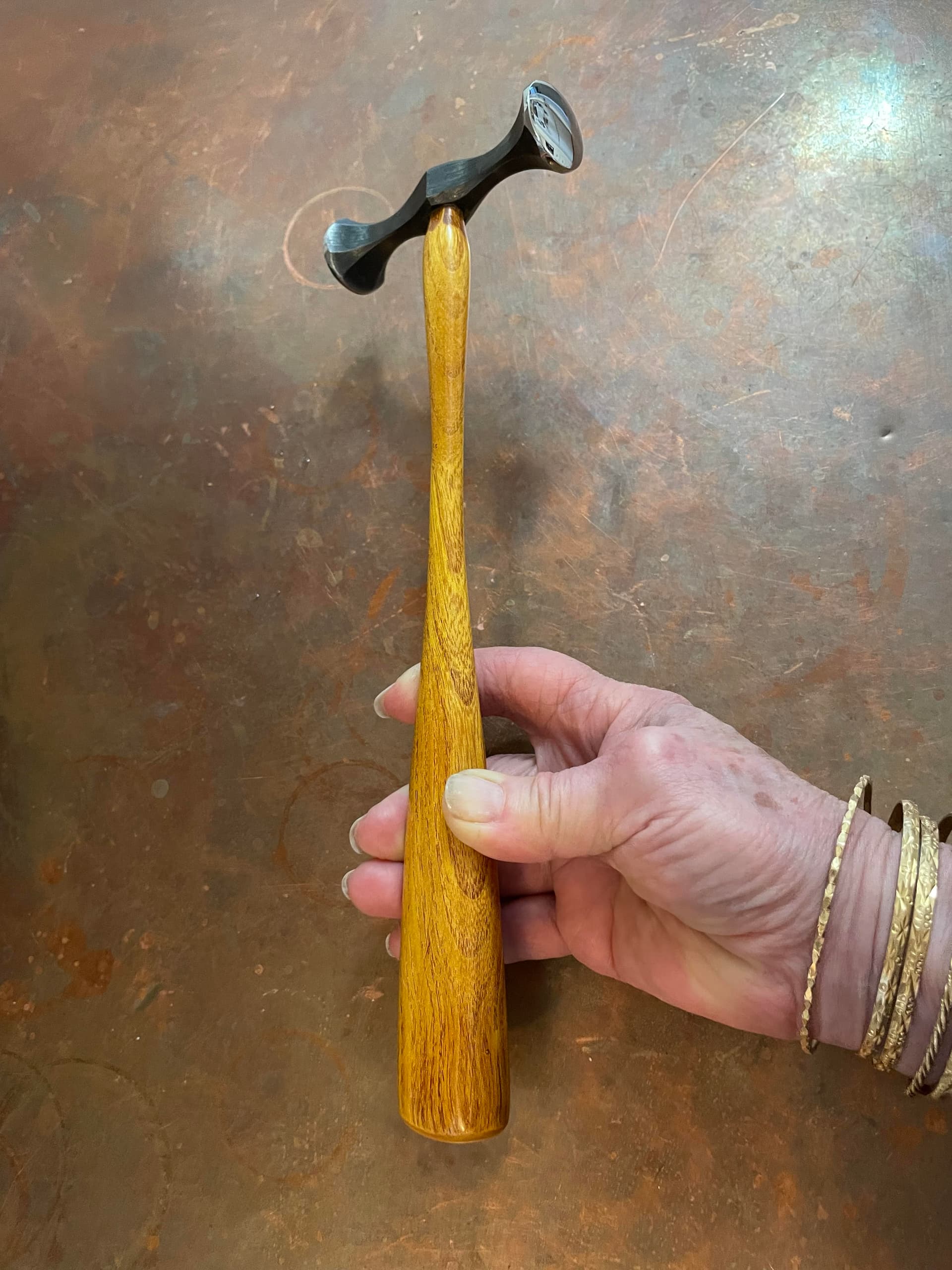

Speaking of hammer fetishes… I own a beautiful Herman Hammer designed by the late Jeffery Herman. It’s like my Dixon chasing hammer. It’s so perfectly balanced that gravity pretty much does the work for me. It’s a thing of beauty and cost me more money that I have ever spent on a hammer. I was so enraptured with it for the first few weeks that my husband Tim was starting to get jealous.
