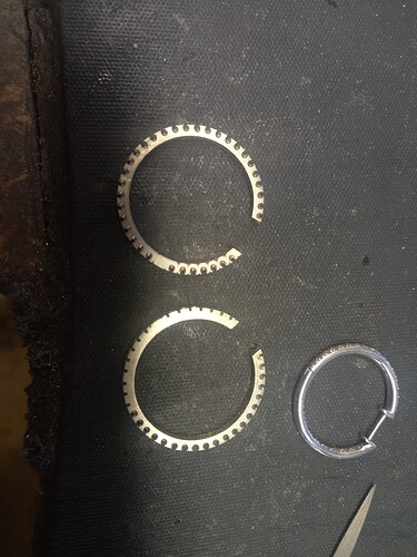

I love making these sorts of hinged earrings:
