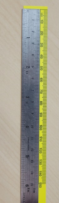

In working on a positioning issue with my laser I discovered that one or more of my rulers is off:
Which 15cm / 150mm ruler mark is accurate? Or are both off?
The top steel 6 inch ruler has Otto Frei’s name on it, the bottom paper/plastic ruler says Rio. Neither seller actually made these so I’m not faulting either one. They disagree by a little over 2.5mm.
I used digital and analog calipers set to exactly 150.0mm and both matched the steel ruler, so that’s the only one I will use now. It is good to know.
Neil A

Now, I’m obsessed with comparing 6" rulers. So far the Otto Frei ruler is matching up exactly with all of the other 6" steel rulers that I have floating around. I don’t think I have any of those yellow flexible Rio Grande rulers anymore.

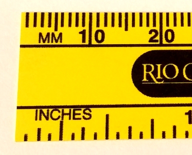

I reached out to Mark Nelson, Education Director of Rio Grande to ask about the ruler discrepancy.
Here’s what Mark said. He also attached a picture.
“Hey Jeff
We checked stock and they are all good. We measured from the mark where the measurements start and not at the end of the ruler.
Not sure how neil_a3 is doing it.
I hope this helps.”
Yesterday I compared an Otto Frei 6" stainless ruler to a Contenti 6" stainless ruler. Those two rulers also matched up perfectly.
Maybe Neil A got a bad one?
Jeff
I mean, those two rulers are absolutely different but it’s only off by 1-2 mm.
It’s a conspiracy!! :joy:
You’re right! I didn’t see that until I blew up the image. Those two Rio Grande rulers are not a perfect match, close, but not perfect. I’ll double check later today, but I’m pretty sure that the Contenti and Otto Frei rulers that I have are a perfect match.

We [Rio Grande] measured from the mark where the measurements start and not at the end of the ruler.
Mine do not have the unruled margin at the end as in Rio’s photo. Here’s mine:
I used the ruler as it was…ruled. Mine are between 15 and possibly 20 years old so Rio’s current flexible rulers are new & improved.
I have another narrower 6 inch steel ruler stamped “Freemans” and its markings match perfectly with the Otto Frei-labeled steel ruler.
For most usage the minor discrepancy is no big deal but my CNC mill is precise to hundredths of a millimeter so if I want to mill a seat for a cab for example, I need to get reasonably accurate measurements.
Neil A
