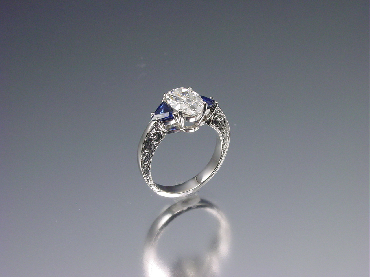

The opal pendant below was fabricated with 19, 20 and 23 gauge wire (all customer’s stones). The two rings show tapered round and flat wire prongs. The round prongs on the oval center are 20 gauge and the sapphire side stone settings are 22 gauge. The flat prongs on the radiant center are roughly 1.2mm by 0.9mm, tapered to just over half of that. The aquamarine sides are set with 22 gauge round wire…The bottom galleries on both rings were pierced from 18 gauge sheet, the upper center stone galleries were fabbed from flat wire, the side stone settings were cut from 16 gauge sheet. The shanks were both forged from approximately 4 X 4 square. All were started from ingots; forged, rolled and drawn into shape.
