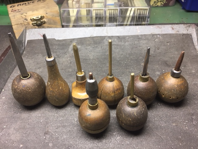

In this photograph; you can see my 3 steel pushers. There are as well 3 Brass & 2 Copper metal-pushers.
My choice can be now two-fold; either I make a totally new metal pusher, or modify what I have.
(I prefer a new series of pushers to be 100% ‘untouched’, just in case some newer tools are needed at a later time!)
"I do not buy new tools, I just modify with what I may have, at a moments notice!"
