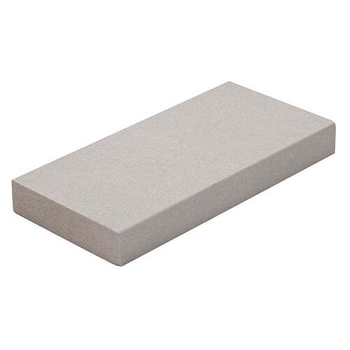

Yeah I just had a tip break yesterday because I didn’t polish with my I think it’s called Arizona Stone
Probably Arkansas stone. Attached is a link to one, but it is only an example.
