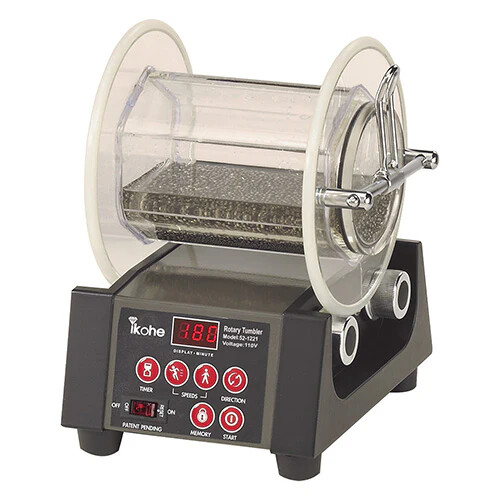

To all the Meixner guys - there are better new rotary tumblers - and some really lousy copies. The newer ones are see-through six sided plastic with an ingenious cover that never leaks. I like the ones that have an auto reverse. I bought mine from Rio a long time ago but they only sell some Durabull thing now. I wouldn’t use them with an abrasive. I recommend running with about 25% to 30% steel media and solution to just almost cover the steel.
As to magnetic pin finishers - they do a couple of things very well - cleaning up castings and initial smoothing - sorta - of small stuff. They do not polish - they leave a sparkly finish - which is nice if you are not into high polish. They are really good for cleaning up parts in progress. I especially like them for prepping parts that need to have patina applied. It opens up the surface just enough to really “take” a LOS solution. I’ll try to dig up a picture of what I have.
Meantime - this is a Gesswein one - note the closure.
About Rotary tumblers - there is a cheap one from Vervor that looks good - I don’t recommend it since I’d rather buy quality once. Judy
