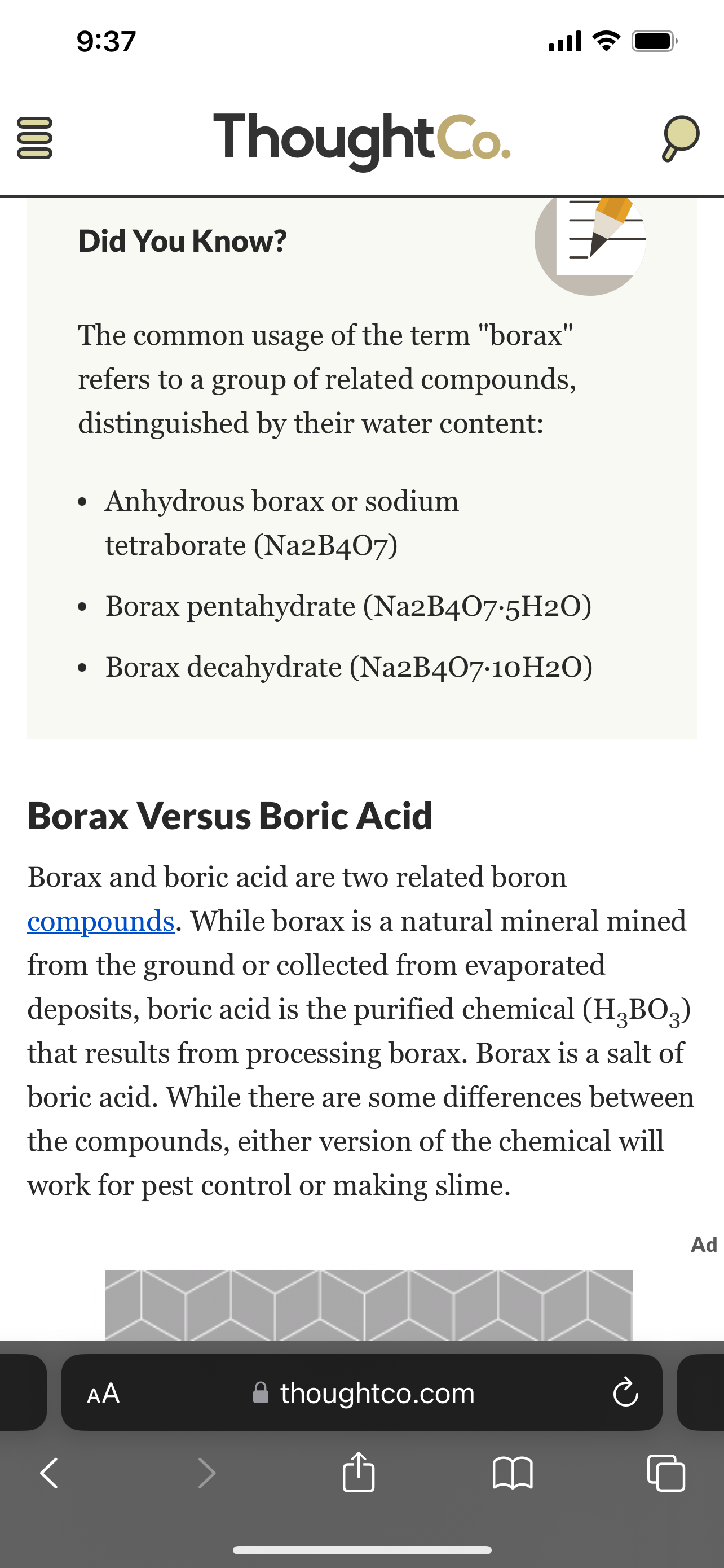

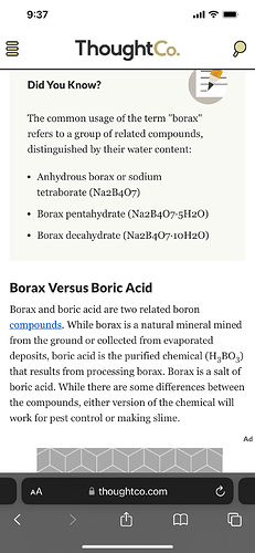

what kind of borax do you all use?.. cheap 20 mule team laundry borax? or a dehydrated preparation?
laundry borax bubbles up when heated and makes a mess…Also had problems with sticky build up.
Any suggestions?
Borax out of a box that I bought years ago…Rob
house hold laundry borax like 20 mule team or prepared dehydrated borax?
I use pure powdered borax that came with one of my casting molds. Try using less borax. Just sprinkle some on, then torch, then a little more till you have a nice coating. I think I had bubbles when I first started and it was from too much borax to start.
dehydrated borax from supply stores costs more… laundry borax is pretty cheap… not dehydrate, bubbles up before it glazes… may be just using small amounts in increments would not make a mess. thanks,
Hi,
i read about this somewhere…deca versus penta……number of water molecules…versus anhydrous
julie
laundry borax is decahydrate… both penta and deca have a lot of water… bubbles up with heating before becoming glassy… Borax “dihydrate” has the formula Na 2B 4O 7·2H2O, which is actually anhydrous, with the correct formula Na 2B 4O 5(OH) 4 . It can be obtained by heating the “decahydrate” or “pentahydrate” to above 116-120 °C. Anhydrous borax is sodium tetraborate proper, with formula Na 2B 4OH. This is the stuff that is ground up to make dehydrated borax flux…water is driven off by heating at a less than 200C… I guess that one can make up a batch by heating it at 450F in a pan in the oven, cooling it, then breaking the borax glass off and putting it into a pepper mill… never tried it… could be worth doing for a home experiment.
