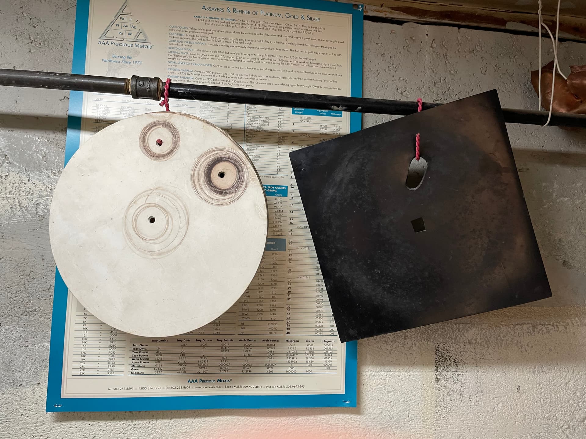

What kind of pad are you using? We have two kinds. One for vacuuming the investment and the other heat resistant one for casting. The investment pad is slightly softer and can adjust to slight leaks.
