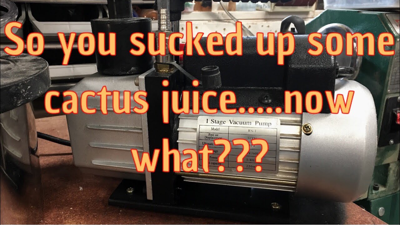

How to clean a contaminated pump is another matter so I tried: “how do you clean a vacuum pump that has had oil sucked into the vacuum chamber” and got some youtube hits, the following being the only one that was a direct answer. I dunno about the cactus juice…
Youtubes can be a great help, and maybe there are others that would be useful.
