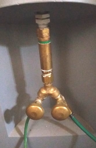

Two fittings like the following, one for fuel the other for oxygen, are all you need for two torches.
That shows my oxygen concentrator, flashback arrestor, and the Y fitting.
You can shut off / open whichever torch lines you want to use.

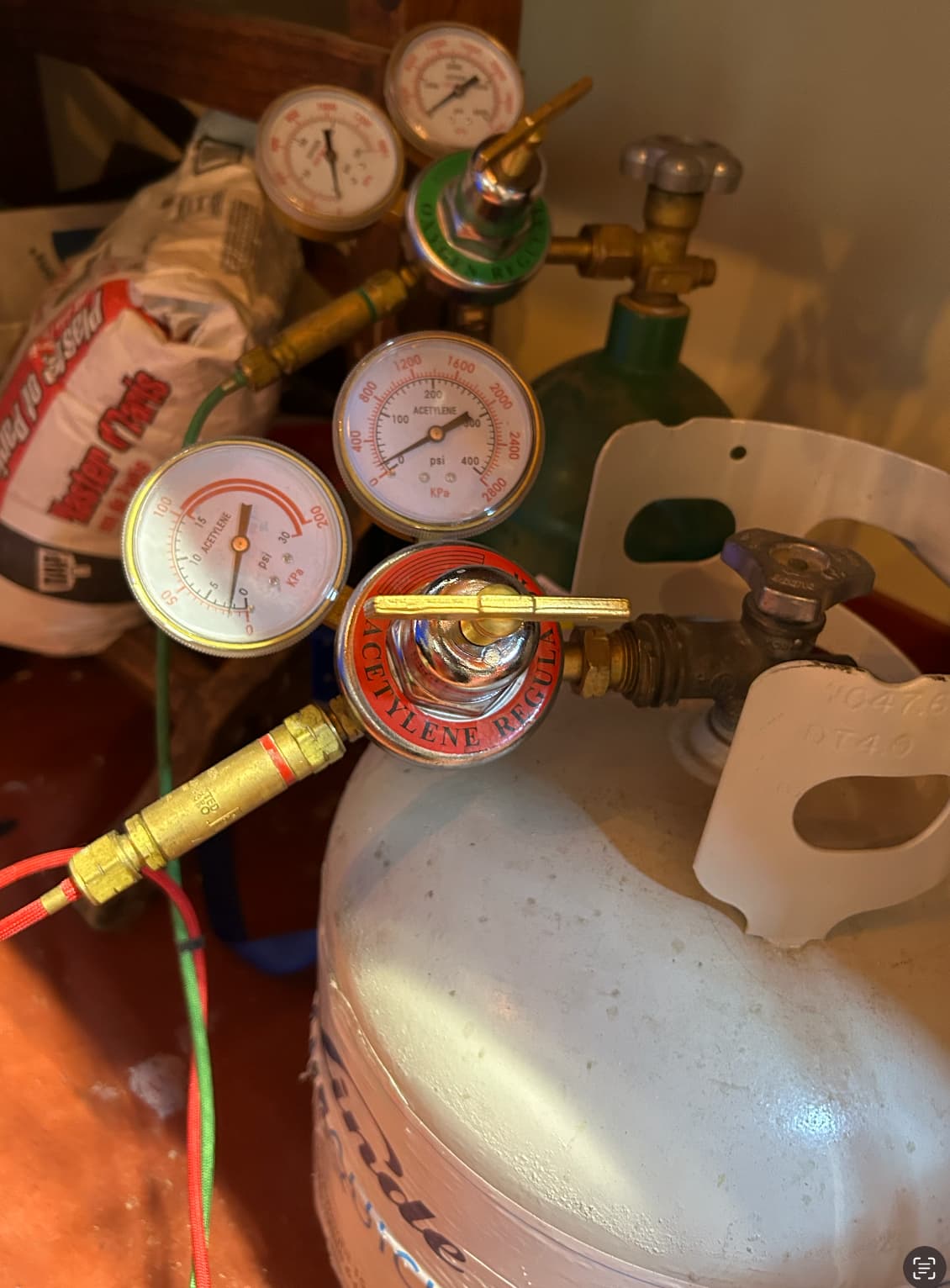

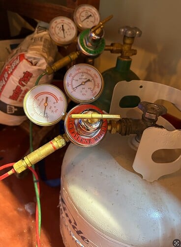

I think I will just run a short hose to a piece of plywood holding my mounted flashback arrestor, followed a mounted wye, since I am uncomfortable hanging so many items from the necks of my tanks. (picture of current setup with regulators and arrestors as-is)
Connect the Ys that Neil showed you after the flash backs. You can then use the valves on the Ys or your torches to control what goes where. Just remember to turn off the one that isn’t in use. You can see my arrangement if you go to the Shop Shots page of my website. What larger torch are you thinking of?..Rob

Thanks, my foot is getting better. I see that you are using an acetylene regulator on what looks like a propane tank. While some of them might fit, the gases are different and this may impact the material compatibility, performance and possibly the safety of your torch. You also have a very small O2 cylinder. You will go through O2 very quickly. This is why many of us have switched to O2 concentrators. With a concentrator the supply of O2 is limitless, but the pressure, while fine for regular fabrication and annealing, may not support bigger melts. I keep a regulated O2 cylinder handy for just that purpose and also have an electromelt furnace for very large melts. Good luck and keep us posted…Rob

I keep looking at that photo with the acetylene regulator on the 20lb propane tank. Is the regulator running propane or is the propane bottle holding low pressures of acetylene?
Yes- It is an acetylene regulator on a propane tank. I had the regulator checked at my gas supplier to confirm this was an okay use-case. From what they told me, there is some concern about incompatible pressure ratings in some cases, or degrading valve/seal materials with older/cheaper regulators, but I have been assured this specific regulator is good here. Apparently the only difference is the sticker, but I have ordered a propane-specific regulator as well, to see if I can notice any difference.
