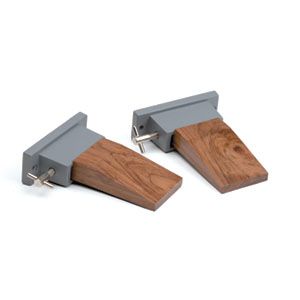

I’d suggest ditching the c-clamp type and get the one that screws
into the front of your bench like this:
And then lets debate about the fact that the bench pins in the
picture are shown upside down.

Hi Brenda,
You might consider getting a GRS bench pin and mounting plate.
http://www.ganoksin.com/gnkurl/1kf
It is made to work with the BenchMate system, in which the plate has
tapered sides and is attached to the front of your bench.
http://www.ganoksin.com/gnkurl/1kg
Different tools can then be mounted on the plate merely by sliding
them on. With the fixed plate setup you can use more than one bench
pin, one right side up the other upside down, using the upside down
one as a flat surface for piercing, the other one as a bench pin is
intended, for filing and holding work against. GRS also has a flat
metal bench pin specifically designed for piercing, and I heard
through the grapevine that Lee (The Saw Guy) Marshall may have been
toying with the idea as well. Can’t wait to see what he comes up
with!
Dave Phelps

between his feet. He used his “bench pin-on-a-stick”, a hand drill,
and a jeweler’s saw to expertly saw out the customer’s name in brass.
So one way to use a bench pin, depending on where you do your work,
is just to put it on a stick and clamp it between your knees. How
simple can it get?
Jay Whaley
You can have two bench pegs as shown on my bench. The centre peg has
been changed since the photo was taken. Please excuse the bear
bottle it’s the only photo I could find :))
Chris
