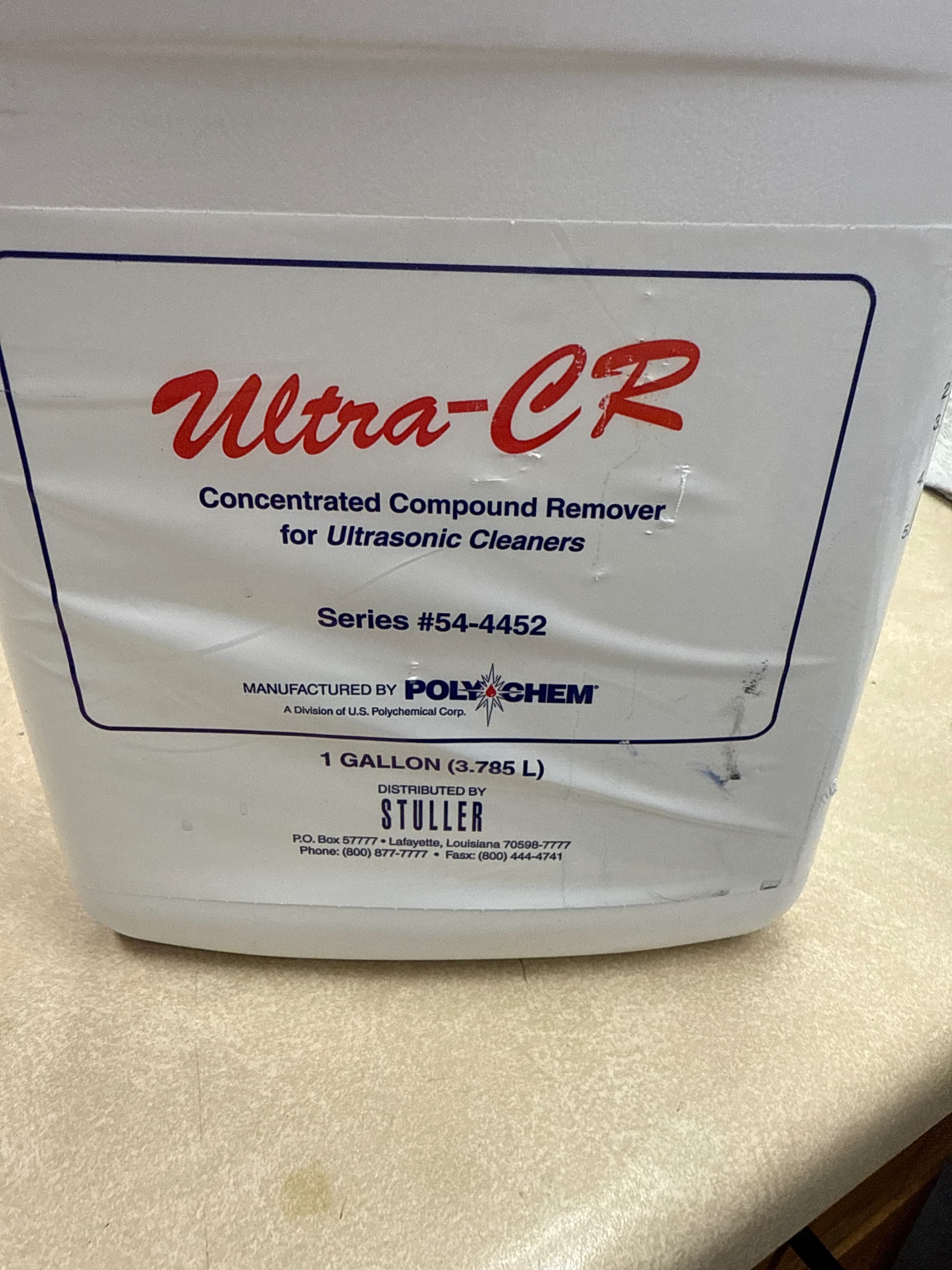

Been using Ultra CR for about 25 years now. Works great and is gentle on all stones. There really isn’t many stones that I don’t put in it for cleaning. No ammonia so there is no cent to it.
