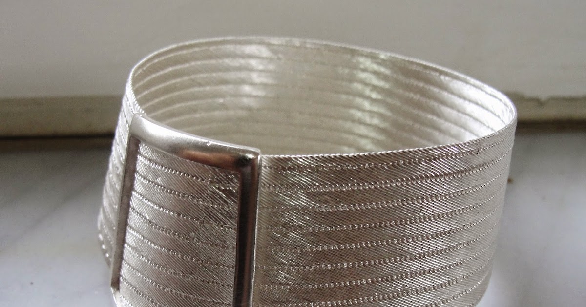

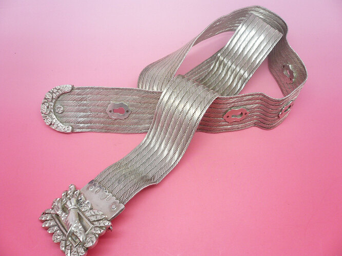

Just because it floated to the top of what passes for my mind: does
anybody out there know how to make (or know in what book it is
explained) how to make that flat herringbone looking wire braid that
you see in a lot of Turkish work? Looks like a flat strap of flexible
metal. You can’t really see the wires from beyond 5 feet.
I do actually have a sample of a cut end of a piece of it. I picked
it up with the idea in mind to reverse engineer it, but haven’t had
the time. At this point, asking is probably the more sensible thing.
It can’t be too hard, because apparently a lot of the real stuff
comes from village women working out in the boonies, with not much in
the way of fancy tools. (Not ANY in the way of fancy tools, most
probably.)

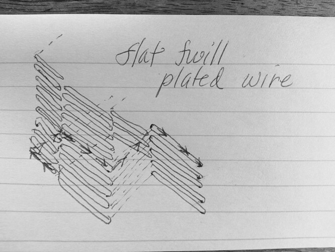

I have been investigating the same thing (refer to attached pic) for
a while. What I deduced doing a sketch for myself is that it is
basically a “chainlink” structure like that used in fencing.
The twill span is about 5 wires or threads. The wires are formed in
a V that drops 5 wires, catches and the goes back up. Eventually,
there are interlocking diamond shapes, with both the front and back
faces of the belt /band identical. It’s really quite elegant. I
haven’t thought about how to actually warp the loom of sorts that
would be needed, but that is the structure.

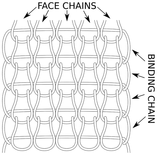

These are assembled from several lengths of plain loop-in-loop chain
fixed to each other side by side.
First you make as many loop-in-loop chains as necessary to make up
the desired width. Then, placing the chains side by side so that the
loops line up, a long loop is passed through each aligned transverse
opening and interlocked with the next transverse loop.
If, for instance, you have a flat chain that appears to be composed
of 5 loop-in-loop chains, there is actually a sixth chain, the one
that binds them all together.

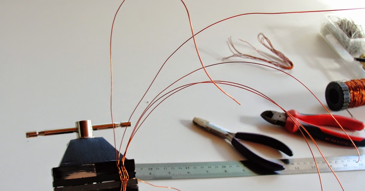

I’m including a picture of the sample piece I’ve got. I got the tag
end of a bit, so I could see how it unraveled, rather than buying a
finished piece just to destroy it to take the chain apart.
I’m not entirely sure it’s loop-&-loop. Looks to me more like it’s a
bunch of jump ring coils threaded through themselves and then rolled
flat. Sort of like a chain-link fence. I just haven’t had time to
sit there with a microscope and follow one blinking wire all the
way back through. For scale, it’s sitting on my bench pin. And this
is a larger one. They make them much smaller.
