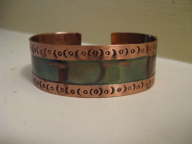

That’s odd. I did a beautiful bluish green torch coloring on a
bracelet I made out of copper, and I lacquered it using Minwax metal
lacquer (in the black can). I had no problems with the color
disappearing. I wonder why I didn’t but others seem to?

Sometimes they just get less intense It varies with the color and
the coating. But I guarantee the wax changed the color to some
degree.
