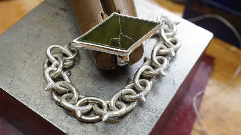

Here’s what we did when a student here wanted sturdy ovals for a bracelet chain, I repurposed a 1/2" spanner and sawed a slot in the end. Note that mandrels need not be the perfect shape of the required oval:
