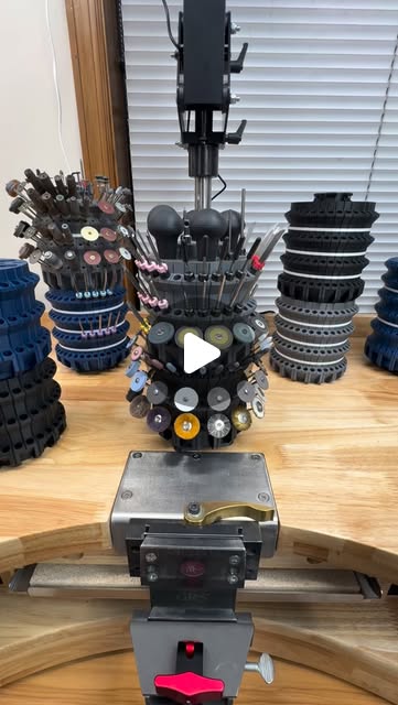

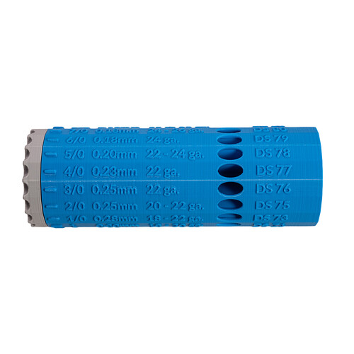

I just saw these on instagram and thought i would share…since the holidays are right around the corner!
here is the website! who’s with me:rofl:![]()
oh my! there is a beading tool tower tool…and a speed wire tower…
julie

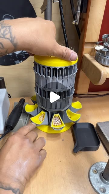

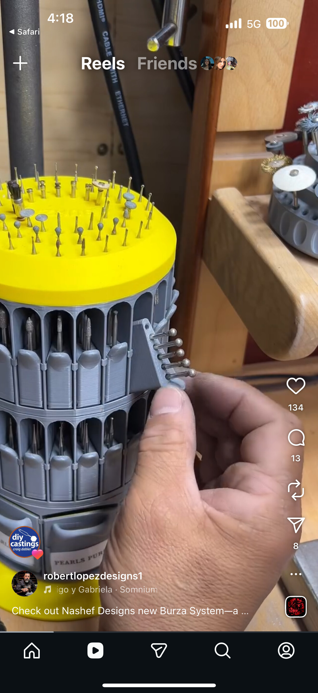

here is another interesting accessory tower storage system…this one make interesting use of the interior space, with pull outs
i went to the website, nashefdesigns.com
but did not see this newest tower listed yet
bur! there were many other interesting storage ideas!
julie
This is really cool! It looks like it’s one of the options on the Burza system. https://www.nashefdesigns.com/product-page/burza-system As you click through the photos, the pull-out module comes up.

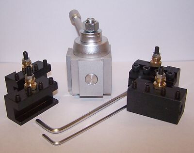

More than two decades ago I made a quick-change tool post and several tool holders holders for my little Sherline lathe because I felt the one made by Sherline was overpriced and I didn’t care for the half-round design. The tool post and holders I made were inspired by the commercial item pictured below, but mine is not an exact copy. Instead, I drew up my own design from scratch in TurboCAD, then machined the project from aircraft aluminum that I had in my scrap box.

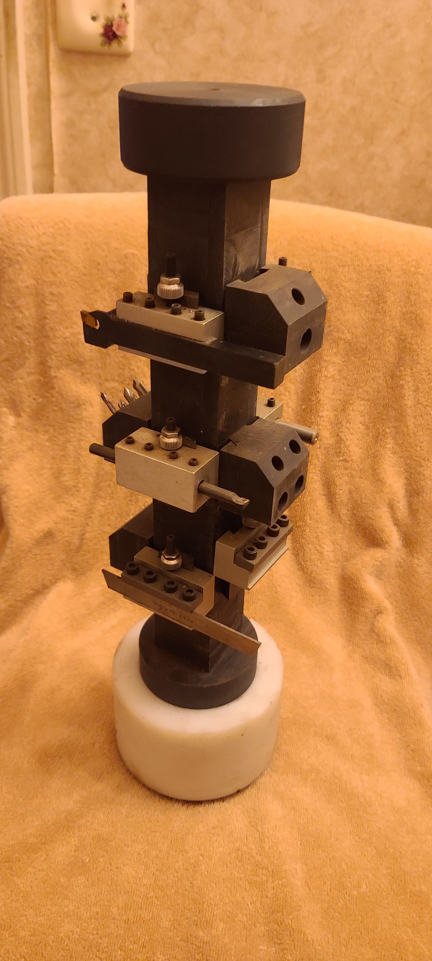

It was cumbersome to store the tool holders in a drawer in the workbench under the lathe, so I decided to make a rotary storage tower. I used a piece of large diameter black Delrin rod I got via Scrap Patrol (scavenged from a local business with their permission). I turned and knurled one end to make a handle for the top so it could be easily rotated. I then milled the rest into a long rectangular shape with a bunch of dovetail bosses that permit the tool holders to drop in place with just enough friction to be held securely without falling off when the tower is spun. I also made Delrin carriers with drilled holes for tools that mount in the MT0 lathe tailstock. I made a base from a piece of white nylon (another Scrap Patrol score) mounted on a steel base to provide enough weight that it’s not tippy, and I milled a bearing race and added ball bearings so the tower can rotate smoothly. It isn’t pretty, but it’s functional enough to comfortably suit my needs:
Jeff, I tried to upload a video clip of this thing rotating, but the site said video file extensions are prohibited. Is that something I did wrong, or is it a site security policy?
