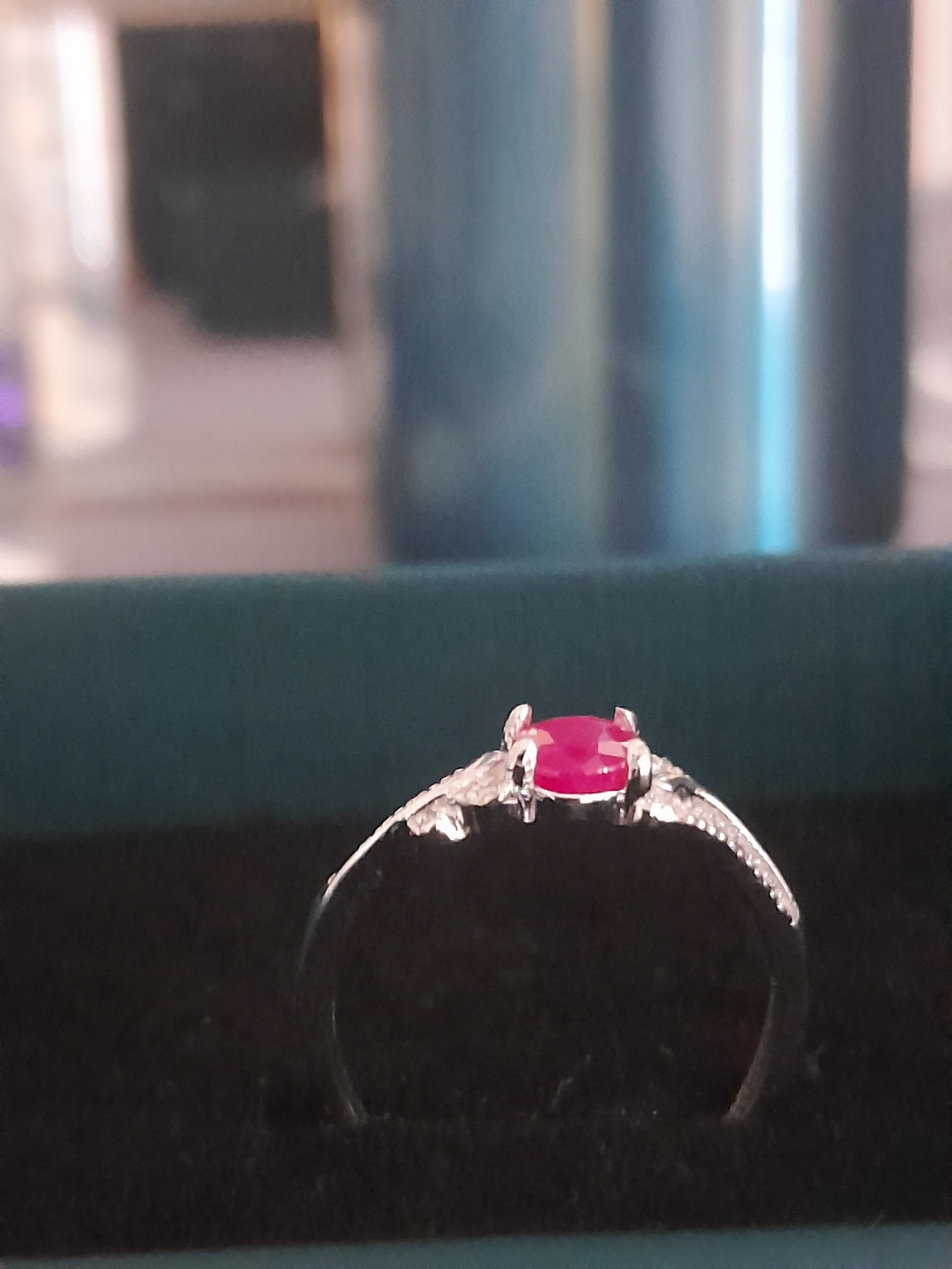

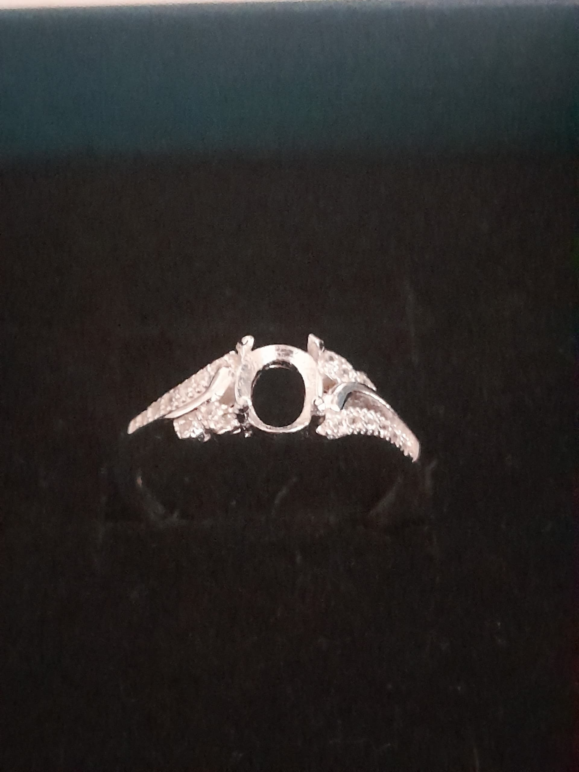

So i have a ring blank prong setting
7mm x 5mm
Stone fits in perfectly (oval)
Should i just tighten the prongs (eg. tighten and fold over) or should i cut the seat etc.
With a dremel and burr its slipping because of the size i think.

Folks probably have different opinions here, but I think your best path forward is to carefully bend the prongs over as they are. If you don’t have much experience with setting a faceted oval stone, there’s a good chance that you’ll make it worse by grinding a seat with a Dremel tool. What kind of metal is it? Gold? Silver?

Hi:
Here is the short answer to your questions: Make sure the stone’s pavilion fits the seat; as you say, if it fits perfectly, you don’t need to cut one. As for the prongs or claw, you will need to cut a notch that matches the girdle/pavilion profile; this notch is usually cut to 1/3 the thickness of the prong. Cutting deeper than this will weaken the prong. Then close the prongs in a crosswise (opposite-prong) pattern. Usually the top of the prongs needs to be shortened and dressed to make them even and rounded smooth. Cup burs are good for this, though it can be done with a barrette file that has a smooth edge; just be super careful not to scratch the stone.

You didn’t mention what kind of bur you are using, but for a setting like this, I usually use a high-speed steel (HSS) 90° Hart bur with the ring blank in a standard ring holder against the bench pin. The bur should be appropriate for the size of the stone/prong. You can also do this with a tri-square file. A 5x7 area is large enough that it shouldn’t be too hard. This might be a better strategy if you are afraid of risking damaging the ring blank. If you mess up the prongs by overcutting with the bur, or worse, you will have to remove and solder in new ones.

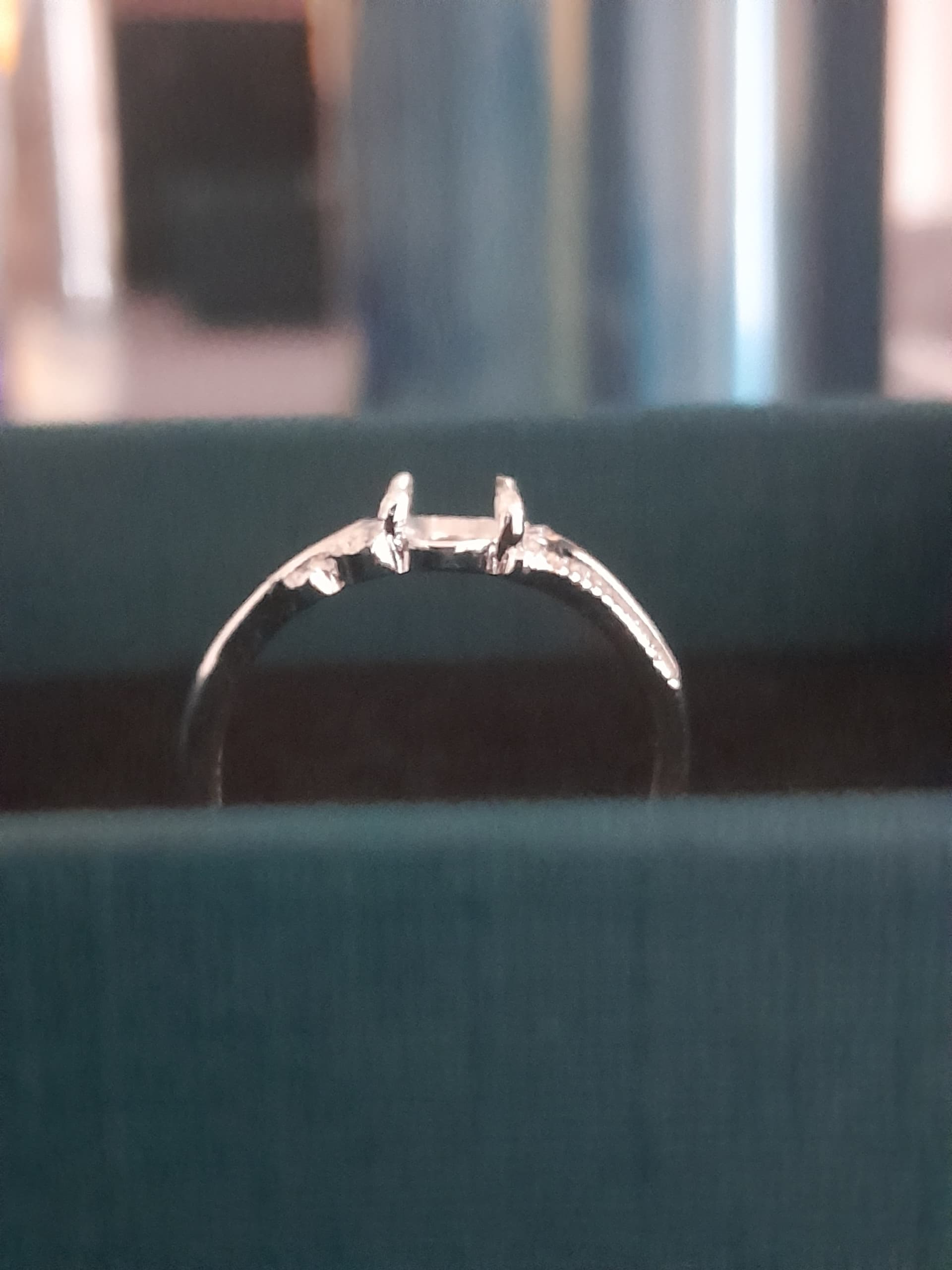

Well, for starters, I would not try to set a stone in that ring. Why? Because it appears that the under gallery is thinner than the rest of the ring. Thus when worn the thinnest area will bend first and the stone will likely pop out of the mounting. Now that said I could be wrong because in the photo I can’t see how thick much of the shank as well as the bottom of the shank are.
If you have never set a faceted stone in prongs I would recommend that you have a professional stone setter do that for you. If possible it would be a good idea to watch that person as they set it so that you can learn how to do it yourself.

Yes, you are correct about the ring, a better ring can be used to set this stone, and definitely a good idea for long term to get a stone setter and watch and learn from him.
Yes exactly what I was thinking, dremel will make it worse, as i dont have much experience in this field. Its 925 silver.
