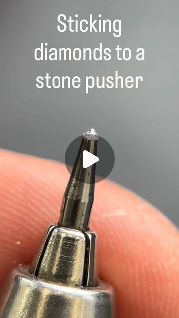

Hi, i saw this post and thought i would share…
i have read that many people lick their metal “stone picker upper” sticks instead of using beeswax…
this trick uses a low dish of water…and a hole in the end of a re-purposed bur…
says the water holds the stone on the tip of the tool with surface tension…
well…i guess that explains the “spit” technique as well :joy:

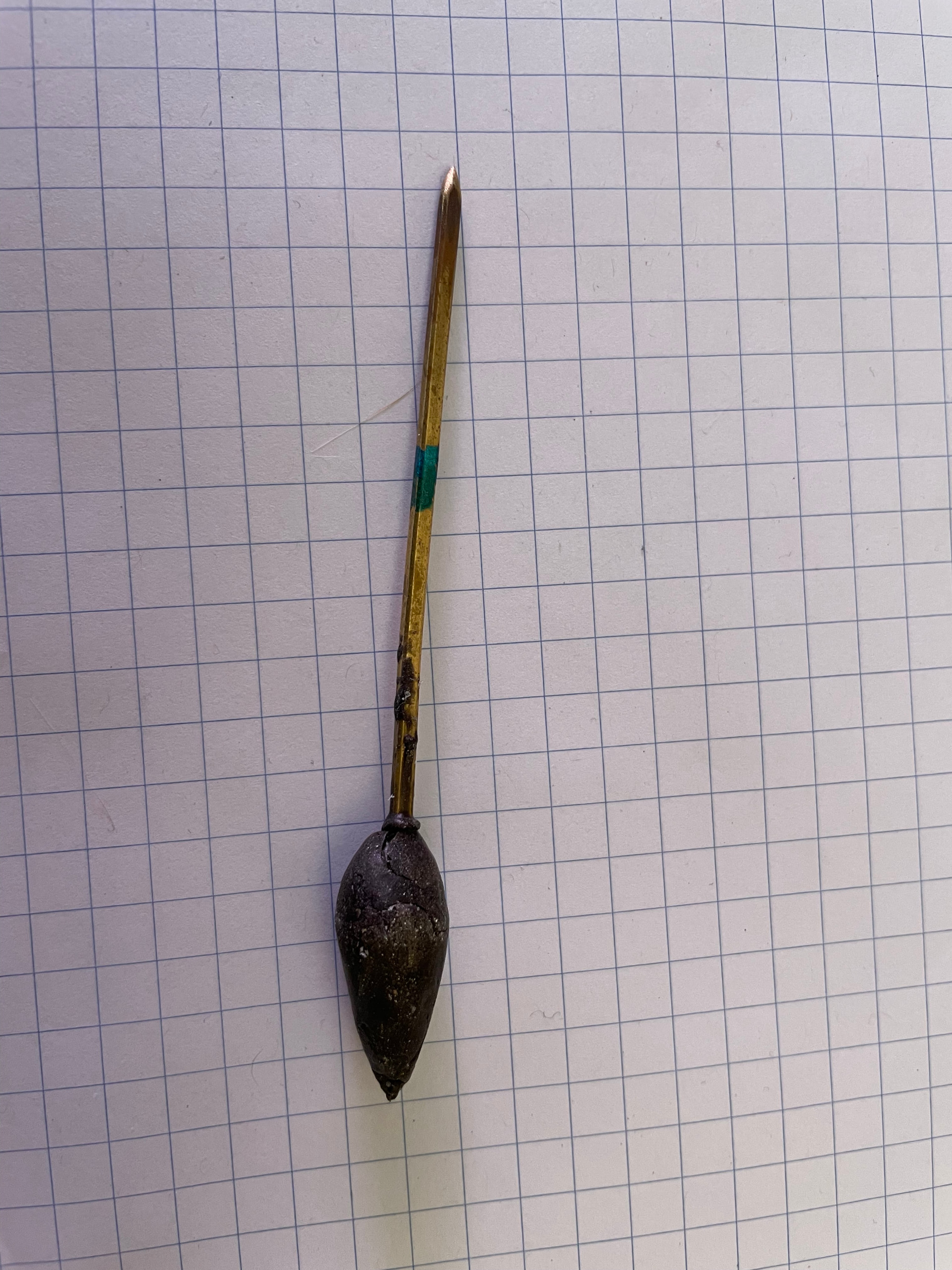

We are old school in our studio. Tim and I just use a small brass rod and attach a mixture of semi soft wax and charcoal dust. Gouda cheese wax works very well. It is so easy to use. We can alter the shape and size of the sticky bit depending on the size of the stone. The other end is filed and polished to a point to help poke things like mele into the pre cut seats.
