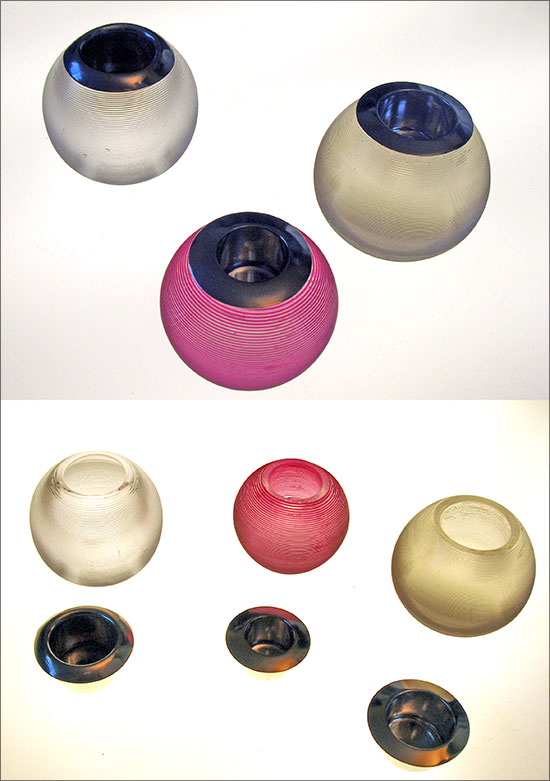

Materials: Sterling Silver .925
Dimensions: 25mm deep the rim 10mm
These scored crystal balls were absent the cups for the matches they were intended to hold. I think that they were from Tiffany and brought to India and Turkey in the 18th century.
I think that bringing something back to life is as important as making something magic and new. A Lee Marshall Bonny Doon 20 ton Hydraulic deep draw press and kit were used for this project. I used automotive tools to make the washers that made the rims. The cup is 25 mm deep and the lip 10mm. I made a custom dooming block to get the anticlastic curve to match the crystal strikers.
They matched, they looked beautiful and I used my carpentry skills and tools to complete this project.
