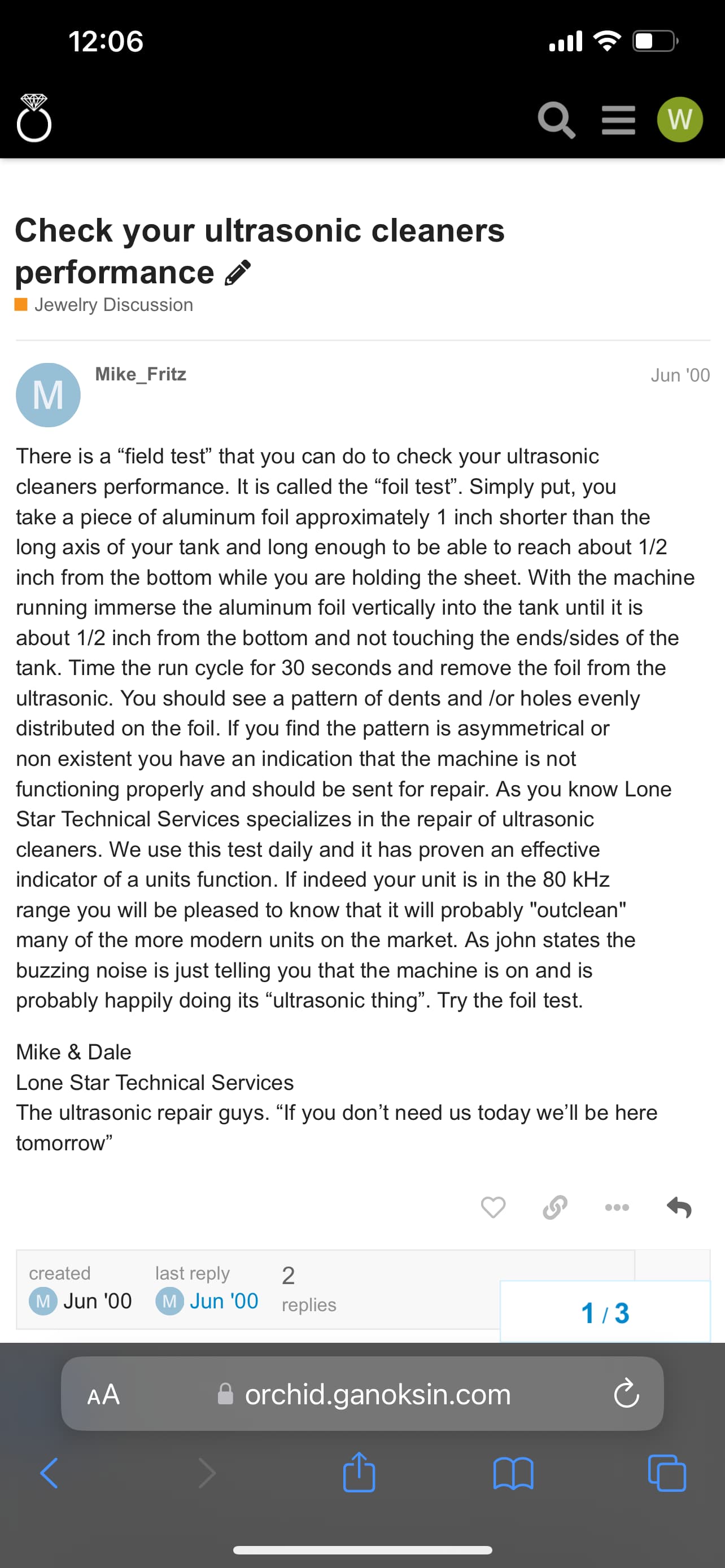

there is a test that you can do, using foil in the bottom of the tank in solution, to see if the cavitation is firing on all cylinders, or not (is cavitation the right word for the ultrasonic action?)ā¦ie: if the foil doesnāt pit uniformly and evenly, then some of the thingies are not workingā¦
i will try to find the test info and post it laterā¦

here is a foil test post

i believe there are multiple āthingiesā under the tank, that cause the cavitationā¦if one or more are not working, you will see areas on the foil that are not affected and remain smooth

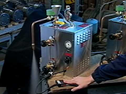

here is a 12 year old video that talks about reimers steamersā¦this looks like the model i haveā¦
