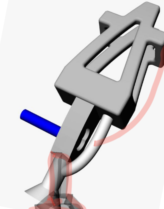

Hello, in the attached images I have a piece (Grey) that had some trouble completely filling in during casting (Silver). I have three options for additional feed sprues that I am looking for advice on. I am not sure which option is better. Teh third option has the additional sprue attached parralel to the feed sprue on the bottom of the piece.
Also, please note, the blue colored piece is a pin.
Any advice is greatly appreciated.
Brandon

Hi Debra, the whole piece casted except the inside edges of the piece were rounded off instead of being a nice right angle. This happened on 3 out of the 5 pieces I had casted. Maybe the caster didn’t do a good job? I wanted to eliminate the possibility of this happening again by adding additional sprues.
See attached, red areas, regarding were this problem occurred.
Can you describe what you mean by vent? I am new to this. Appreciate it.
Correction, they weren’t rounded but more wavy. There wasn’t consistency to the fill in those areas.

The arch in the sprue pictured in post 8 is to much of a curve and slams the metal into a wall of investment. You do not want the metal to drag on any surface. If you add a sprue eliminate the drag like you did in pic #3 = Straight and direct.
Pic#3 in your original post is a good sprue for your piece and should be enough to get the job done.
To be safe- you could add a vent but my guess is it is not needed.

Good start, but get the sprue closer to your item. The metal has now to travel too far away, then come back. Point number two: make that secondary sprue ”thicker”.
Remember that the hot metal will only stay hot for a couple of seconds. Every second counts as its now flowing in your flask.

You might try changing the overall angle of attachment to the main sprue / button. Metal really doesn’t like 90 degree changes in flow. That creates turbulence and messes with the results. If the piece can be shifted at least 20 degrees (i did it to the right), them maybe one additional sprue up towards the top might solve your problem. You might need a similar supplemental one the other side as well. I would also shift the CAD drawn additional sprue at the bottom closer to the outside bottom corner edge of your piece.
Just a thought. Good luck.
Eileen
Interesting ideas. It seems that this orientation is the consensus. I will try to replicate on the other side, by passing the pin and see what happens. Appreciate it.
