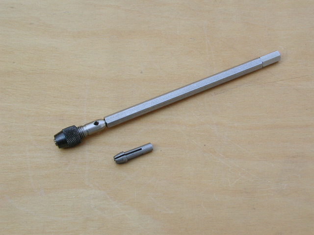

I googled “long pin vise” and came up with these. good for a lead
solder pick!

I am puzzled why anyone would want to use a fragile pencil lead for
a soldering pick. The available metal picks through most suppliers,
with wooden handles are quite strong, and relatively inexpensive. I
have had times when a hefty shove with the pick saved the day in a
tricky (for me) situation. I can’t imagine a pencil lead’s ability to
do that.

HI Dennis,
It’s sort of like having a set of golf clubs: different tools for
different jobs. I’ve got a tungsten rod that I’ve been using
since… well, a while. I use that for jobs where I’m expecting to
need to push on things, but I use the pencils for gold or platinum,
(especially platinum. No contamination.) The gold pieces fit
tightly enough that all I’m doing is just putting solder into place.
If I need to push, I didn’t set it up right first. The pencils are
nice because they don’t suck heat, and the solder just won’t stick
to them. It’ll ride them around, but won’t stick.
