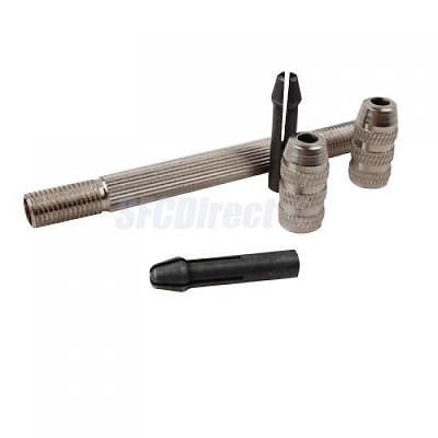

Try “pin vise” and do it on tripps, Rio Grande, fire mountain, etc
John

I would think you can put that thicker lead into any pin vise that
has a big enough opening. Pencil lead would be at an art supply
store. Drafting pencils work like a pin vise but easier.

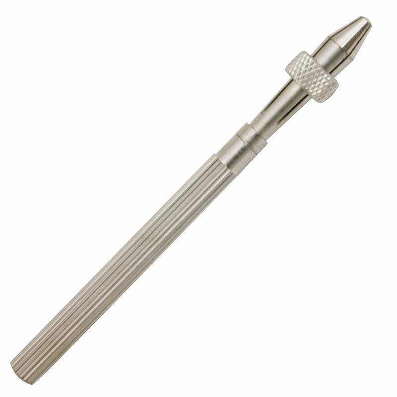

Instead of using the manufactured lead point holders though, why not
purchase just the lead points, and use a jeweler’s pin vise?
something like
or
either style are all metal, and will not melt like the commercial
lead point holders that are mostly plastic will. If you are concerned
with the lead transferring heat to the metal you could wrap the pin
vise in a few turnsof tape to protect your fingers from the heat.

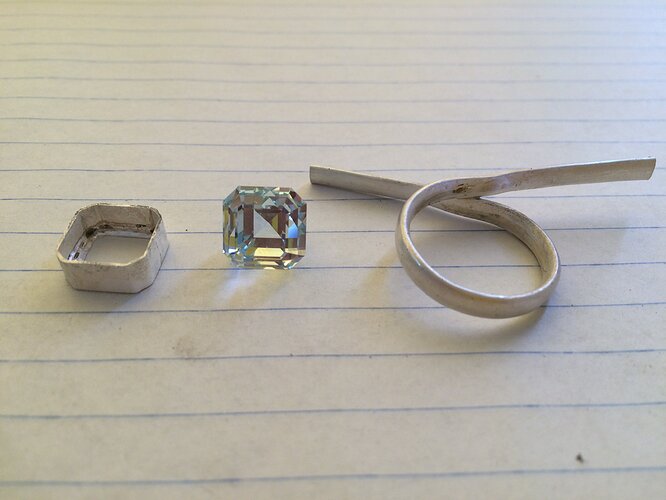

Hi all here is the bezel and blue topaz and ring shank.
Just soldered and not cleaned up. Next pic will be of the finished
ring.
All the best
Richard

Since we’re talking about something you could hold a pencil lead in
to use as a soldering pick, I thought the poster was referring to
something all metal, more like a long pin vise… not a simple
mechanical pencil, which would surely burn/melt…:-)…
Janet in Jerusalem
