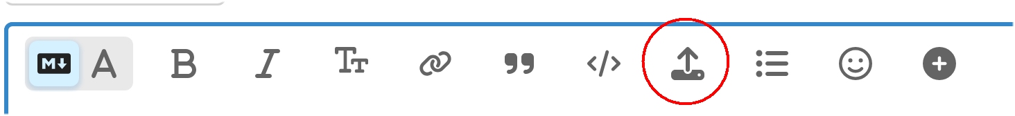

To upload a picture look above where you type your message for these icons. The one circled in red is what you’d click to begin the upload.
