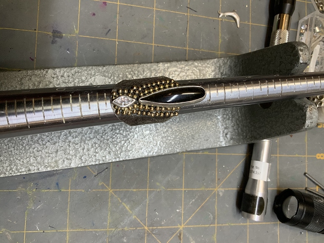

Soldering a wide band ring
So I was working with 18 gauge, 11 1/2 mm wide band. The ring is a cigar band shape. I soldered the band closed with hard solder, From the inside, checking to make sure my solder came all the way through to the outside of the band. I fabricated the ring, setting one large stone and one small stone, tumbled and polished it. I also saw it on quite a few gold balls around the stones. I wore it for about a week, and one day I felt something weird and looked down and the band had become unsoldered in the back. I’ve had problems with other wide bands coming apart, but usually when I am shaping the band or setting the stones. What am I doing wrong?

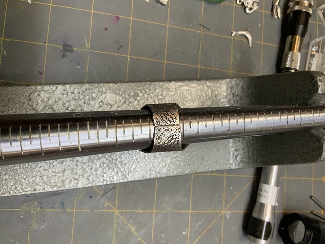

As I take the pictures to share with you it looks like a tiny piece of the hard Solder did not melt properly. I was using chip solder and really thought that I used enough. Also the band was even after I had sanded it[quote=“cbutchko11, post:1, topic:61066, full:true”]

When you first soldered the seam with hard solder And you saw the join completely filled then you said you soldered the two bezels on. Did you do that with medium solder? If not you may have weakened the seam.

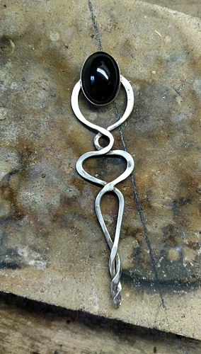

I like the gold granulation. It is a look I use frequently. Not granulation strictly speaking I suppose but a great look. As I look at your photo I think you would benefit by squaring up the joint a little more. I can count on one hand the number of stones I have set in 30 years but I know the work involved to unset them is epic. Can you Kool Jool the stones enough to allow you to solder this with the stones in place? This is a Kilt pin, one of my few set stone pieces before I rolled over the bezel and finished the piece.
Don
Hi Marianne, thanks for weighing in. Yes I did solder the bezels with medium Solder. Also solder gold accents on using easy. When I’ve had solder joints fail in the past, They usually fail when I’m shaping the rain or setting the cabochons or faceted stones. I was really perplexed when the solder came apart after wearing the ring for a few days. I appreciate your help, Christina
Hi, if I enlarge your image, I can see that the edges of your join are not square. The long edges are slightly curved So the metal does not meet well at the sides of the ring. Also I notice that The flat faces, which should butt together, are not actually flatly facing one another.
I think you need to work on those edges to ensure a close and flush fit. Solder doesn’t like to bridge gaps.
