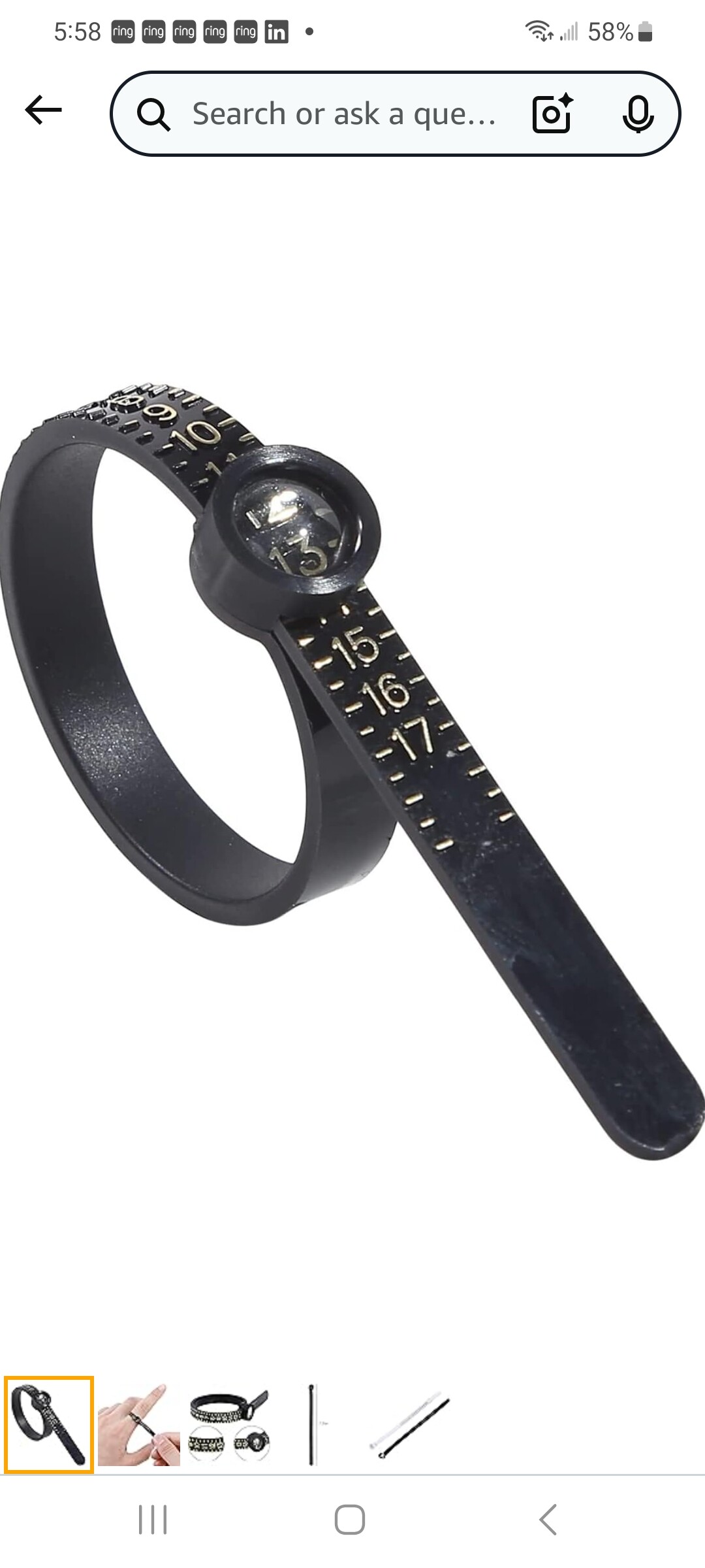

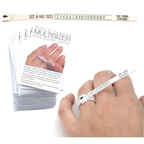

They do make expandable gadgets that can measure ring sizes on different locations on the finger. Here’s one from Otto Frei. I’m pretty sure you can buy them individually on Amazon. (so not a pack of 50)
I don’t think there is a formula. If there is it would be great to know about it.

I am not saying I recommend this ring sizer, as I have never seen it, but the concept is correct. You measure the knuckle with the traditional rigid finger sizers, to determin the minimum ring size that will pass over the knuckle, and then use an adjustable sizer like this to determine the finger size that will snugly hold a ring in place, once it is past the knuckle.
The difference between those to measurements is the problem you now need to try to address.
Good luck. From this point, this becomes more of an art than a science. Every arthritic knuckle, and ring fitting is a unique puzzle.
