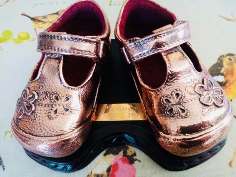

The pprooces for plating leather baby shoes is to coat it with a spray that has powdered metal in suspension. Then it is able to accept deposits. so almost anything can be plated in this manner there are other places this is an example…~~*Stv
