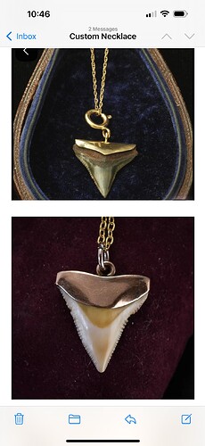

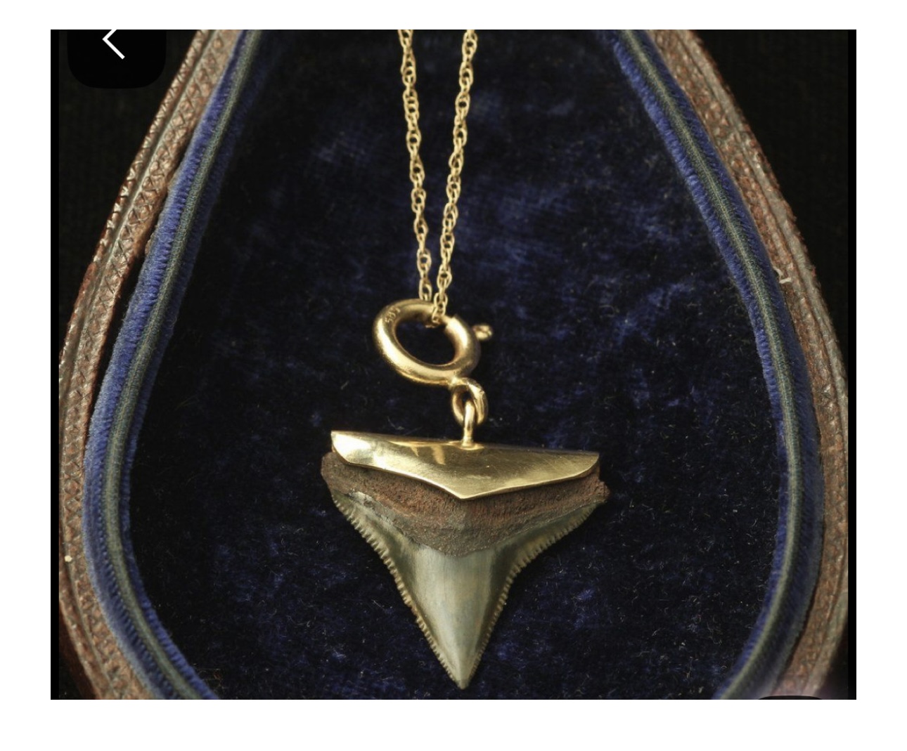

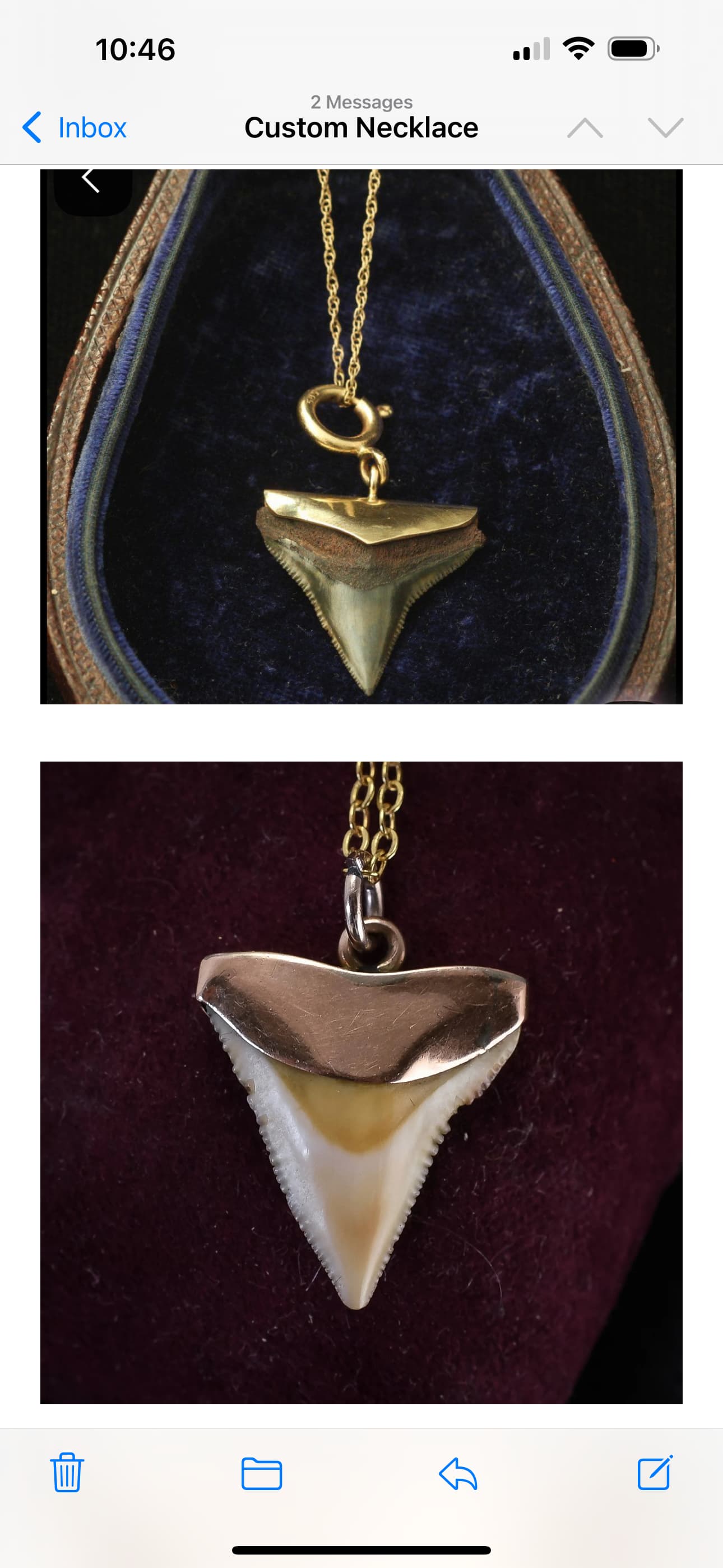

I have been asked to set a cap on a sharkstooth for a pendant.
After searching the topic without success, I reach out to you.
How does one secure the cap to the sharkstooth? Is it glued? Is the post of the bale screwed into the tooth?
I am at a loss and any help will be greatly appreciated.
Here are some photos.
Kind regards,
Lois

Looks like a peg and glue the same way that you might secure a pearl. My brain keeps designing an open setting of two oval shaped rings (round, square, flat wire) that are soldered above the middle of the top with a jump ring soldered to the top of the joint. The oval rings would have to be pulled apart enough to clear the tooth and then carefully bent in to keep the tooth from escaping. Do you really want a spring clasp or a real bail?…Rob

Hi,
sooo…what does the back of this cap look like?…same size/ depth?…longer?…
it is saying “glue” to me…maybe rough up the top of the sharkstooth?…give it a little more “tooth” for the glue to grab onto?…maybe something on the underside of the cap for the glue to grab onto as well?…like…a jumpring…some balls…a coil…
julie
Hi Julie,
This photo is the only angle I have. I like your idea of creating a part that continues down the back a little, for added support. Thank you so much.
