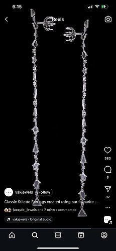

hi
here is a photo of an instagram post with a video showing the different views of a oair if earrings with portrait cut stones…links dont seem to post correctly…you can search for their account…
vakjewels
julie
