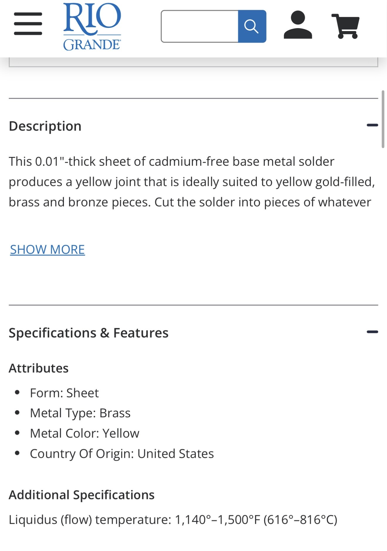

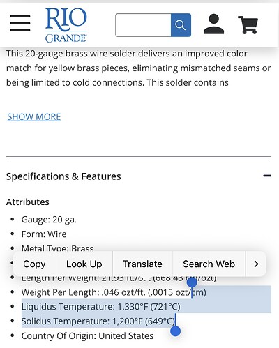

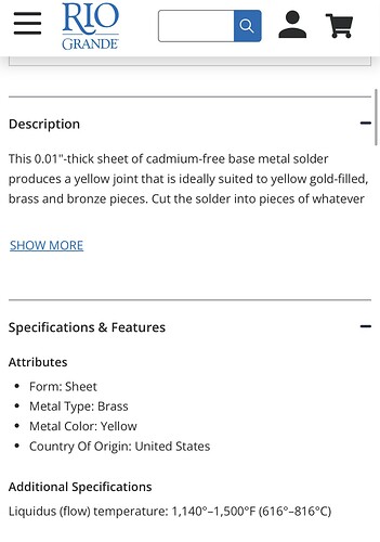

Is this what you’re looking for? Rio Grande sells this:
Sheet Solder for Brass, Bronze, Copper and Yellow Gold-Filled
Item No. 503052
or this:
Brass Wire Solder, 20-Ga.
Item No. 132201
I have it and can’t get it to work with any of the fluxes that I use…Rob
I use the brass wire solder from Rio, and it works for me! It’s still pretty tin color, but not as contrasting as silver solder. I usually use cupronil without too much problem? But it does take a while to melt and can get globby if you use big chunks. I use smaller pieces spread more frequently than I need to with silver.

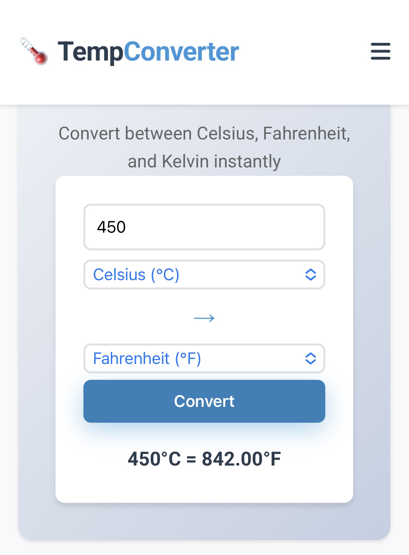

It is pretty much the same, but brazing is above 450 Centigrade and Solder below.

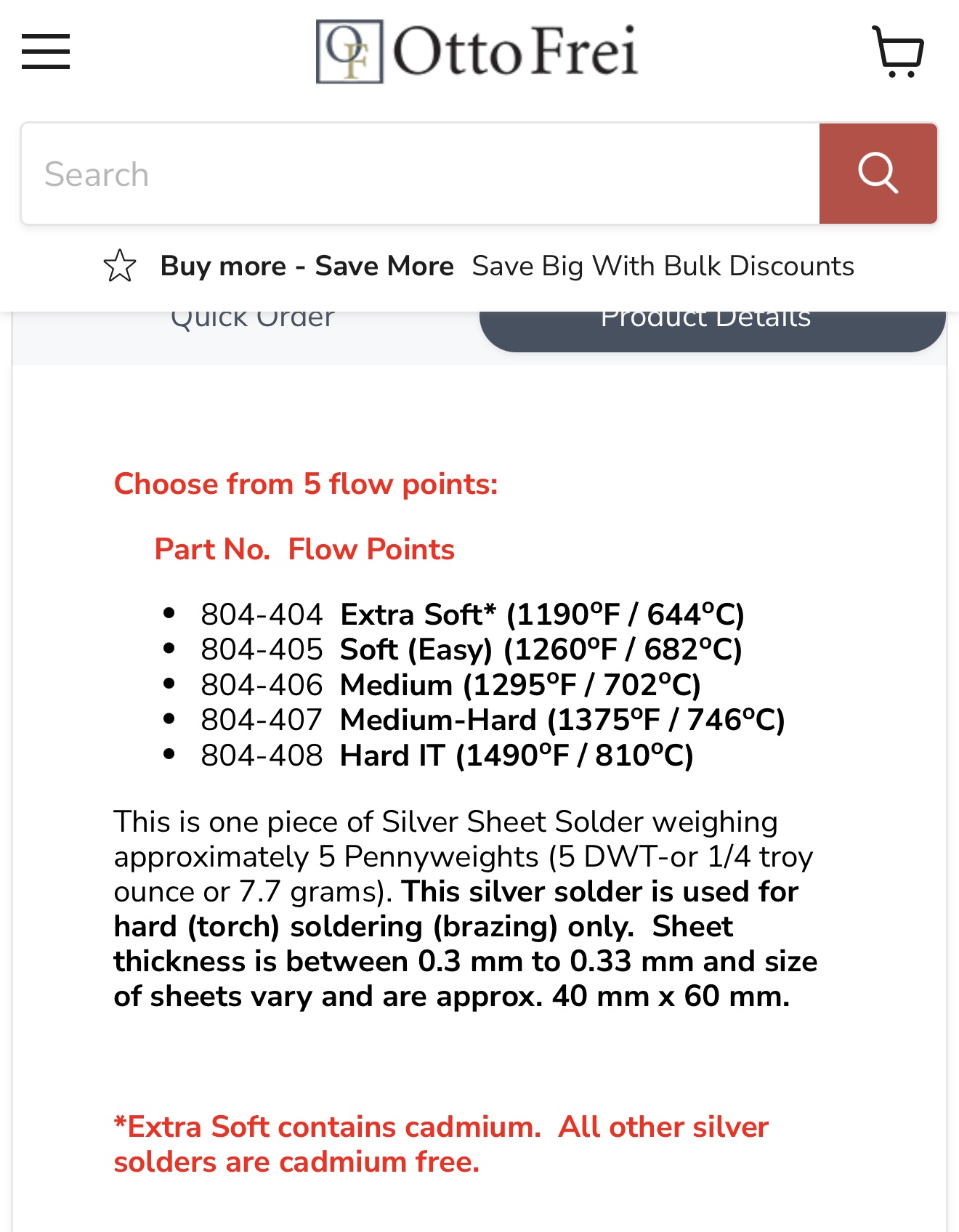

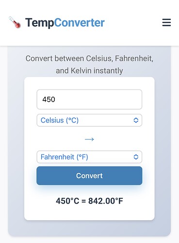

hmmm…i wonder if the 450c point is referring to solders used with soldering irons…versus silver solders and a torch…
julie
silver solder:
brass solders:
