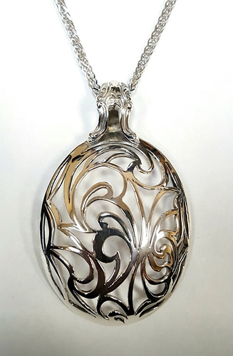

I did this with a spoon from my wife’s grandmother’s silver. We scrapped the rest for a sweet deck. This made her cry and she wears it a lot. Just a saw and a benchpin
Unbelievable beauty…the sentiments are running high on this site. I
apologize for thinking about recycling the old gold…:>(
