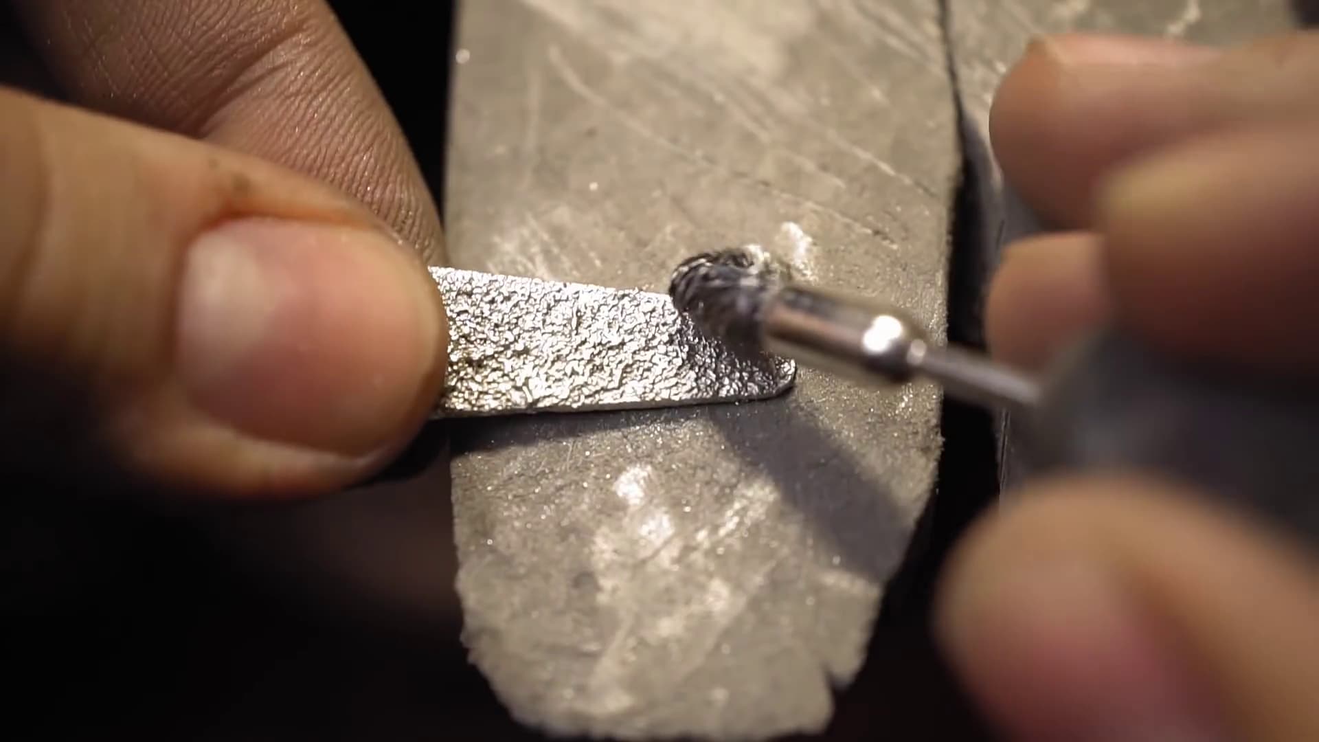

Do you know what type of burr is being used to refine the surface of the fused silver dust?
In this still one can just make out that it is not a bur but a worn down bristle brush.
Cool! I love it. The texture reminds me of granulation. I think I will purposely wear down some of my brushes. Thanks so much for showing this.
