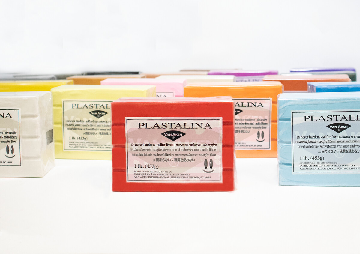

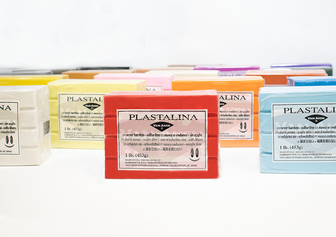

Jason, I use plasticine (non hardening modeling clay) on top of a
steel bench block to support the sheet when hammering from the back
and red pitch when hammering from the front. This is part of the way
I achieve high relief (of course the tool shapes and technique are
critical as well).
To avoid the mess, I spray the piece with Pam cooking spray before
putting it on the pitch. (Any flavor will do!) It’s not so toxic to

hi,
i am not sure what product is being used to imbed the parts, before pouring investment/ plaster over it
this type of modeling clay comes to mind…
julie
Later in the video you will see casting investment poured onto the assembly in such a way that, when it is all popped out of the mold, you have access to the various pieces so that you can solder them together. I had the same question a few years ago…Rob
Thanks Julie!!! Do you know if this modeling clay is comparable to Sculpey modeling clay?
I ask because I already have a quantity of Sculpey that I’ve tried using for this chore, but it leaves behind a slightly oily residue that must be cleaned with solvent before I solder the parts. Otherwise the heated residue burns and leaves a mess on the surface of the silver that prevents me from getting a good solder joint. Unfortunately, attempts to clean the oily residue causes the cured investment to dissolve enough that it sometimes releases parts, creating difficulty and frustration.

Rob, did you ever get the modeling clay to work? Did you find a brand that does not leave oily residue like Sculpey? If so, I’d be grateful if you’d share details…
I bought the clay for other reasons and also bought some investment, but have yet to have a reason to use this technique. I use the clay as a base when I am adding JB Weld to irregular Turquoise stones when I am getting ready to cut them. I was fascinated when I saw these videos and, after watching several and a previous ganaoksin discussion, figured out what they were doing with the clay. The clay never sees heat. It just supports the many pieces until they get held in place with the investment. As for what to buy, I just bought modelling clay of which there are many brands and types. If I ever get around to trying out this technique, I will post about it…Rob
