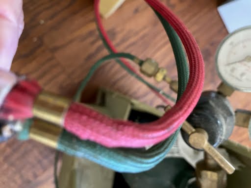

Today I went to check my acetylene/oxy little torch. I have not used my torch in about 10 years. The hoses crumbled when I picked them up and need replaced. No surprise there…
But to my surprise! I expected them to be rubber under the nylon colored covers. Instead I found the tubing is likely clear polyurethane. After hours of unsuccessful searching locally to find a quick replacement I went to my “Old Source”.

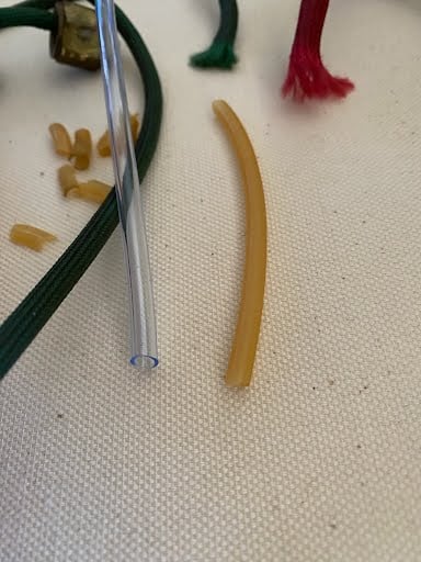

My guess is this old tubing is polyurethane tubing as the above description states. So I’m thinking I can salvage the fitting and replace the tubing with the same size, id and od… I looked at aquarium tubing.

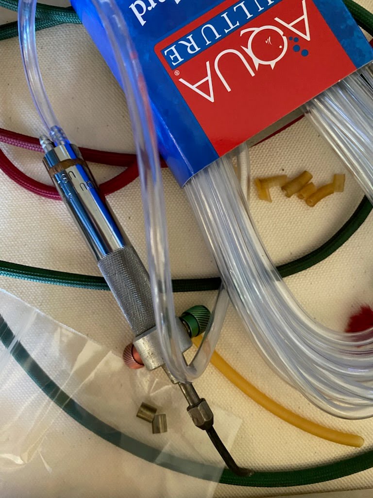

Seems some aquarium tubings are polyurethane some, silicone and some, something else. But only the silicone tubing is marked silicone. I bought 25 foot of Aqua Culture Standard Airline Tubing for about $4. Should be plenty to replace the damaged tubing. However, I’m not sure if it is polyurethane, silicone or something else. The distributor says the information is not in their database. But, I suspect it is polyurethane due to it being more rigid than the tubing marked silicone.
According to my research I think this will work.

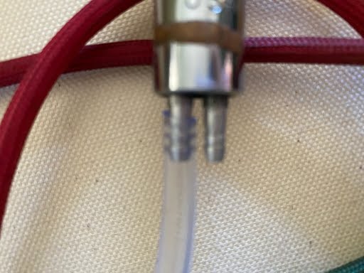

Additional Note: If I do try the Aquarium tubing I will be using/reinstalling the nylon covering also. all fittings are in good shape too.

If you do use aquarium or other clear plastic tubing it might make sense to leave the red & green nylon covering off for a while to see how the tubing reacts.
If it gets frosted-looking inside or shows other signs of reacting with the fuel then It would make sense to replace the tubing. You might not notice a problem until it got bad if you covered the tubing right away.
The nylon coverings look nice, different colors make it easy to tell fuel & oxygen lines, but other than that I’m not sure how good an idea it is to cover things up. Sure for protection from abrasion, but hoses should be treated gently anyway.

Neil, Good idea. I still need to attach the tubes to the torch… will tape the covering in place instead of a permanent solution to check. I plan to check my regulators for any unusual loss of gas too.
All looks good so far. The hardest part was removing the old broken tubing from the dirty nylon covering. The nylon cleaned up nice!
