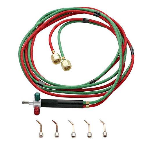

Rob, thanks very much for the response. I’m using an Oxygen Concentrator, 5 LPM, no regulator. I’ve been using this with a Smith Little torch, fusing 16-20 ga sterling wire. The tip that gave me the best control was a Smith #6, but I found I had to dial down the propane at the regulator in order not to get a flamethrower style flame when I lit the propane (I’d been using Paige tips for other work, so this was the first I’d used the Smith tips - they’re new and presumably clean). When I reduced the gas using the regulator, I was able to get a small enough propane-only flame (~2" long). Then adding oxygen for a maybe 1/8-3/16" cone gave me approximately what I wanted to fuse the wire.

    Did you get 5 tips with your Smith Torch?
    (#3,4,5,6,7…with #7 being the largest)
you are currently using #6…have you tried the smaller tips?…like #4…?

Smith Little vs Swiss torch: The observed difference: the Smith tips produce a triangular/conical flame, with a wide cone at the base. With the Swiss + micro tips, the inner cone is more cylindrical, around the diameter of the tip. The smallest tip produces a flame with an inner cone that seems as if it can’t be more than 1/64" in diameter. It’s my impression that the narrow inner cone is a key to the improved control I get with the Swiss (I just started using it today, so this is just a first impression).

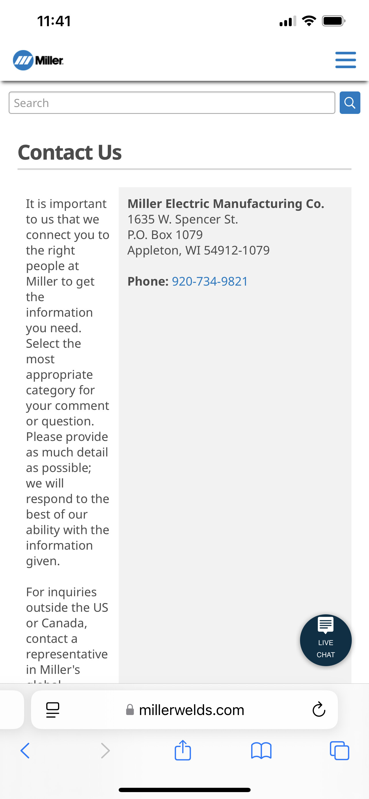

You may want to reach out to support at MillerWelds.com, who i believe makes Smith torches (?)…
the support representative i spoke to was very kind, informative, and very helpful when i called.

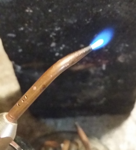

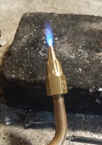

It is also possible to get very small flames. The flames below are well under a centimeter in length.
The following magnified photo is of a #3 Smith Little Torch tip. You can see that the flame is the same size, or smaller, than the base of the torch tip shaft. This was tricky to light. It needed minimal opening of the fuel dial on the Little Torch, very little O2, and use of the candle flame to adjust things until the flame was stable. A Smith #3 can be difficult to set up.
This is of an ImpGen 00 tip sold by Otto Frei.
It’s flame is quite a bit smaller than the Little Torch #3 tip. Again, compare the flame size to the thickness of the torch tip’s shaft.

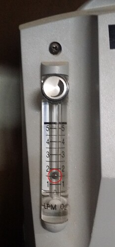

In addition to using a candle when dialing in difficult to light torch tips, it helps a lot to adjust the oxygen at the concentrator as well as at the torch. I circled in red the steel ball that shows gas flow from the concentrator:
Dial the flow rate down to zero to put the ball at the bottom. Get your fuel lit. Very gently increase the O2 at the concentrator, using the round dial shown at the top in my machine’s case, until all of the yellow flame is gone. Fine tune the fuel and O2 at the torch, but also at the propane tank and at the oxygen concentrator if needed.

Thanks for your insights! I started with a small butane torch and worked my way up to the Smith Little with Paige tips - definite learning curve there. With the current project (tiny pieces, fusing sterling), I ditched the Paige tips for the Smith Little tips - big improvement in terms of getting smaller flames - but the Swiss Torch turned out to be the absolute best. Learning curves everywhere. I’m a happy camper now. Today’s modification: regulator mostly wide open (90%), controlling the propane at the torch. It worked, and answers the biggest concerns of my teacher.
