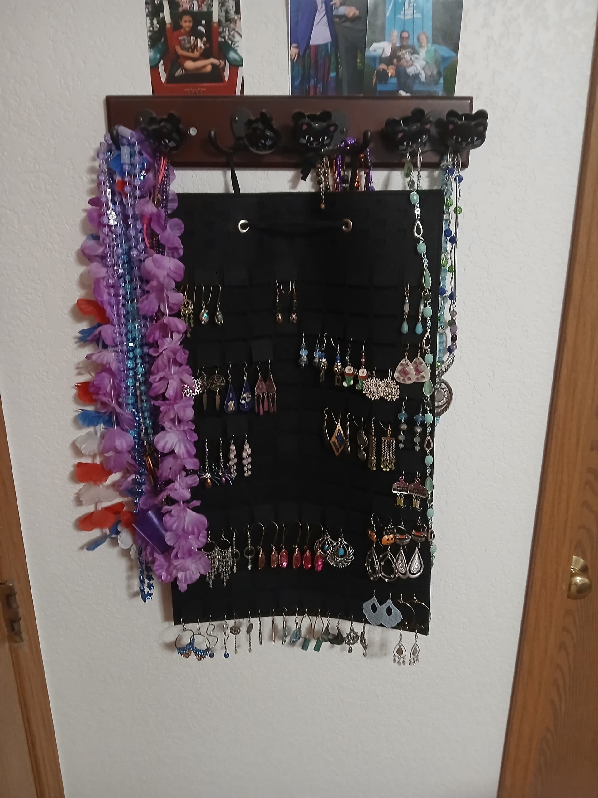

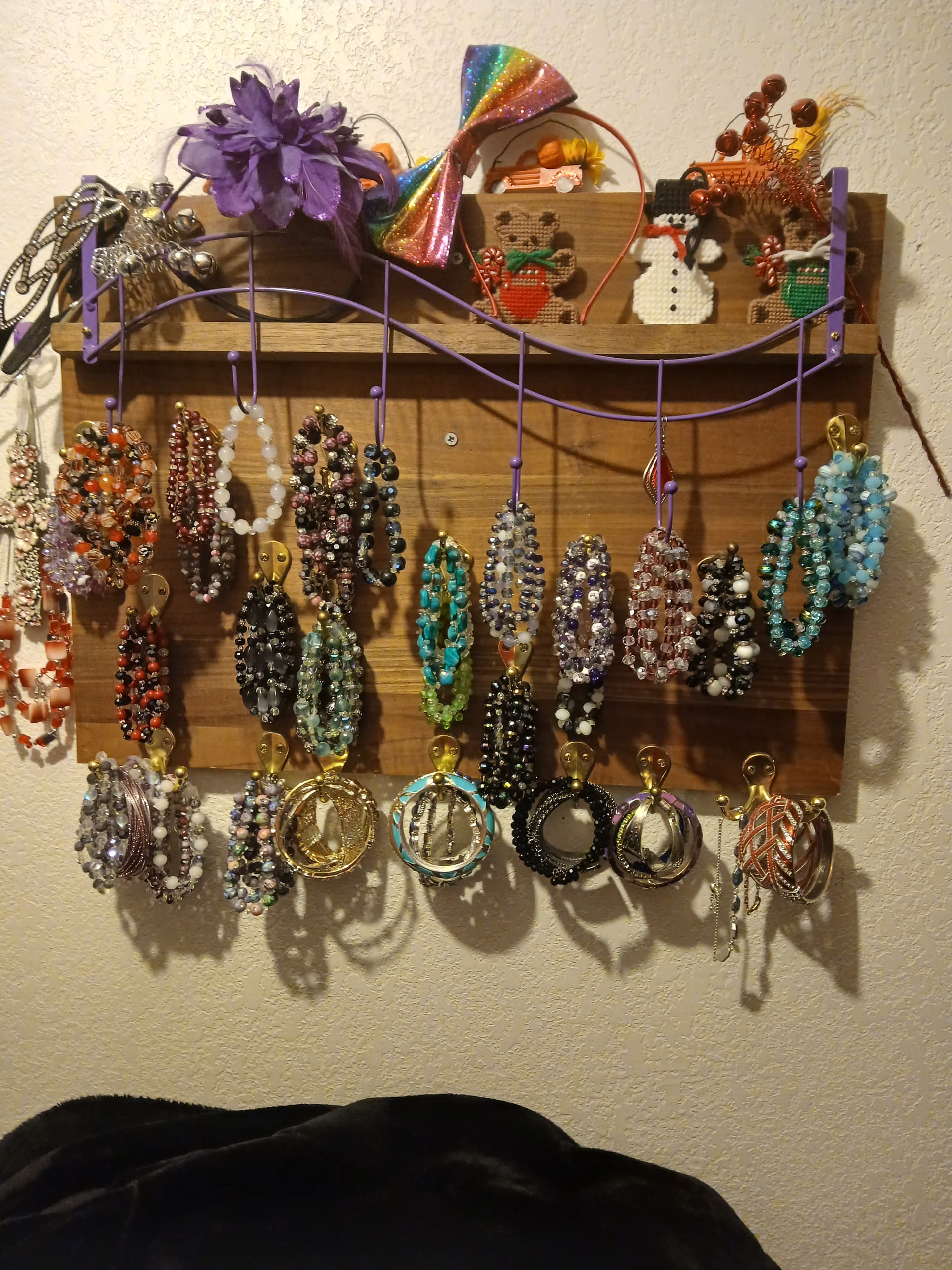

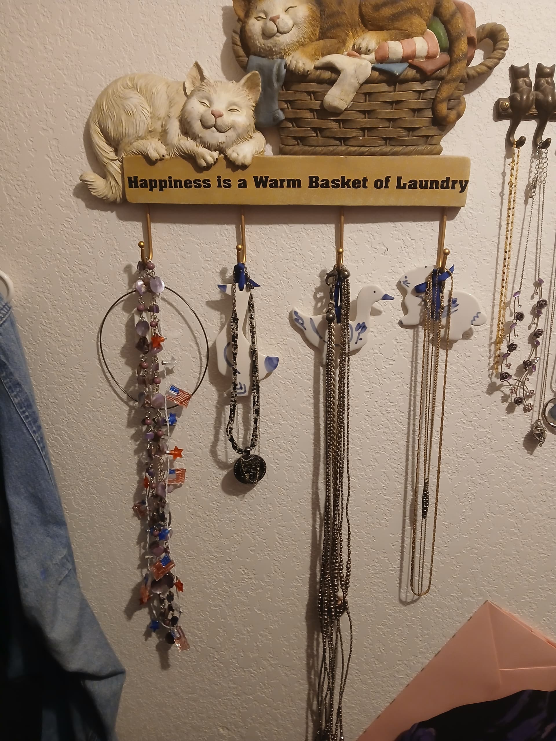

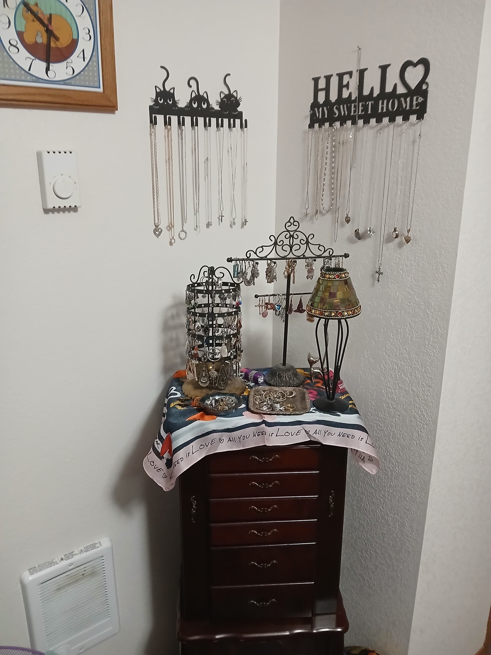

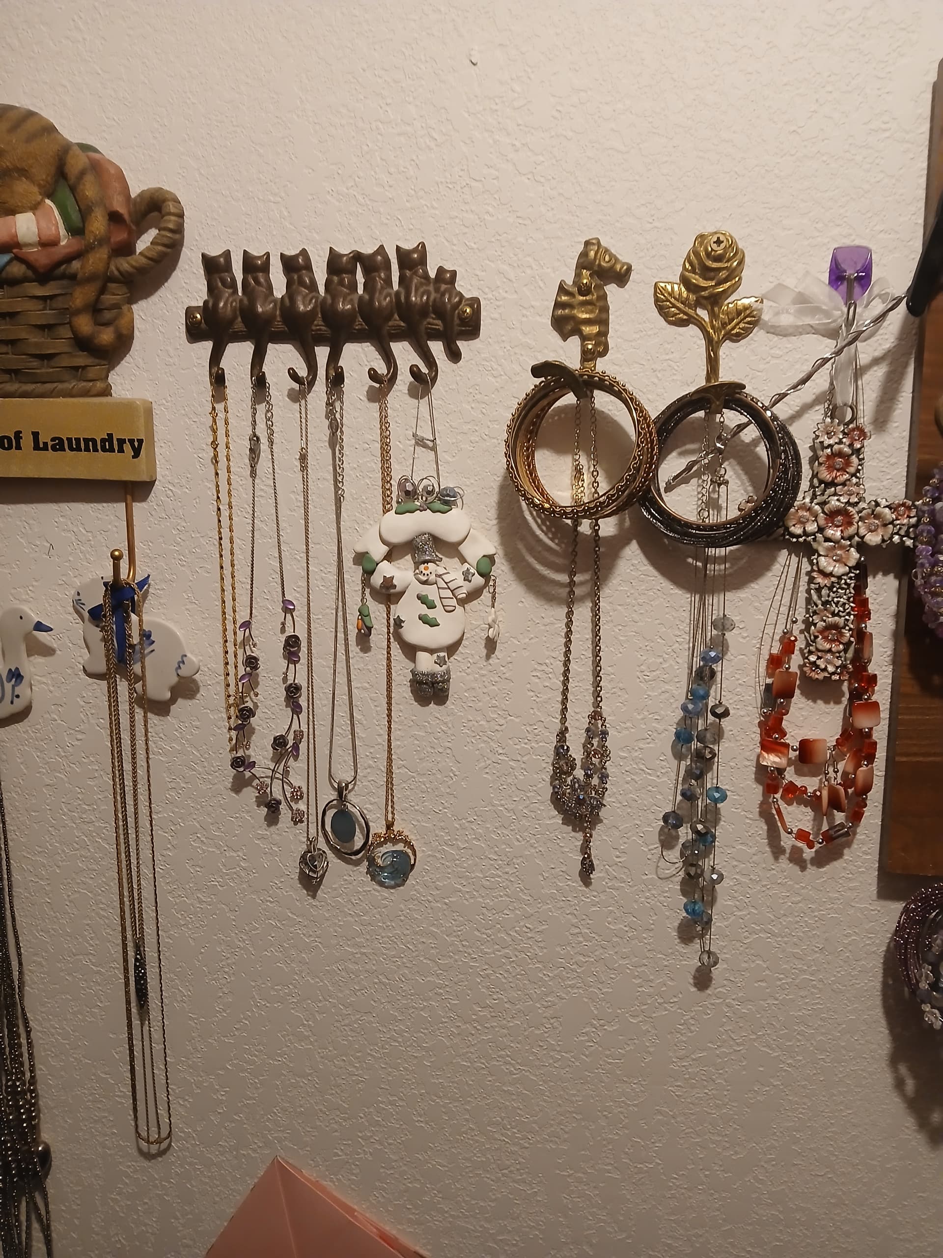

I would like to comment on the displaying and storing jewelry for wife🙏
I am working with a rotary rack, Bearings found at sales, copper wire twisted radiating out from hub connecting to circular band w/holes for ear rings to hang. Not sure how high or how many bands. I am stealing ideas from others and incorporating into my vision. I’ll post pic’s of how I’ve been handling this problem sofar…I just polish as needed, sometimes an impregnated cloth does the trick quickly and oxidation in the right places gives a beautiful contrast. Sometimes just rubbing with your fingers or dawn and a toothbrush. I have a little kit handy..~~*STV
